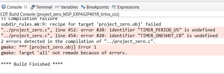

Hello everyone,
I've been trying to get the project zero example running for my CC2650MODA boosterpack (using the MSP432401R development board)  on both CCS cloud and CCS. When I try to run the example on CCS, I get an error message that some identifiers are not defined. I downloaded all the corresponding files found on the example website and are up to date. It was working when I first ran the example about two weeks ago, now it won't compile at all. When it did run it had the same error as with the CCS cloud example described below.
When I try to run the example on CCS cloud, the terminal shown in the README.html file does not match the terminal I get when it runs. The terminal message that comes up in my screen reads only 1 LED service instead of 2. The project does compile and run, but when I use the LightBlue app to interact with the module, the UUID addresses do not match and reads "This is pretty long."
Is this an installation error on my end for both issues? Should I delete the SDK and re-download it? I'm currently using CCS V9 and SDK bluetooth plugin 1.4.

  • Hi Jerry,
    Are you referring to Project Zero which is found in the SimpleLink Academy package?
    This software is based on BLE-Stack 2.2.1, so please make sure you have this software component installed locally. Link:
  • Thanks for the reply!
    I installed the BLE stack locally as recommended and it did resolve the issues with the identifiers, but it gives the same result as with the CCS cloud. The UUID is not read correctly, I can't access any of the attributes, and still says "This is pretty long." I tried running an example on Energia and it works perfectly. CCS automatically detected and installed all updates for the BLE stack file, so could this still be an installation issue on my part?

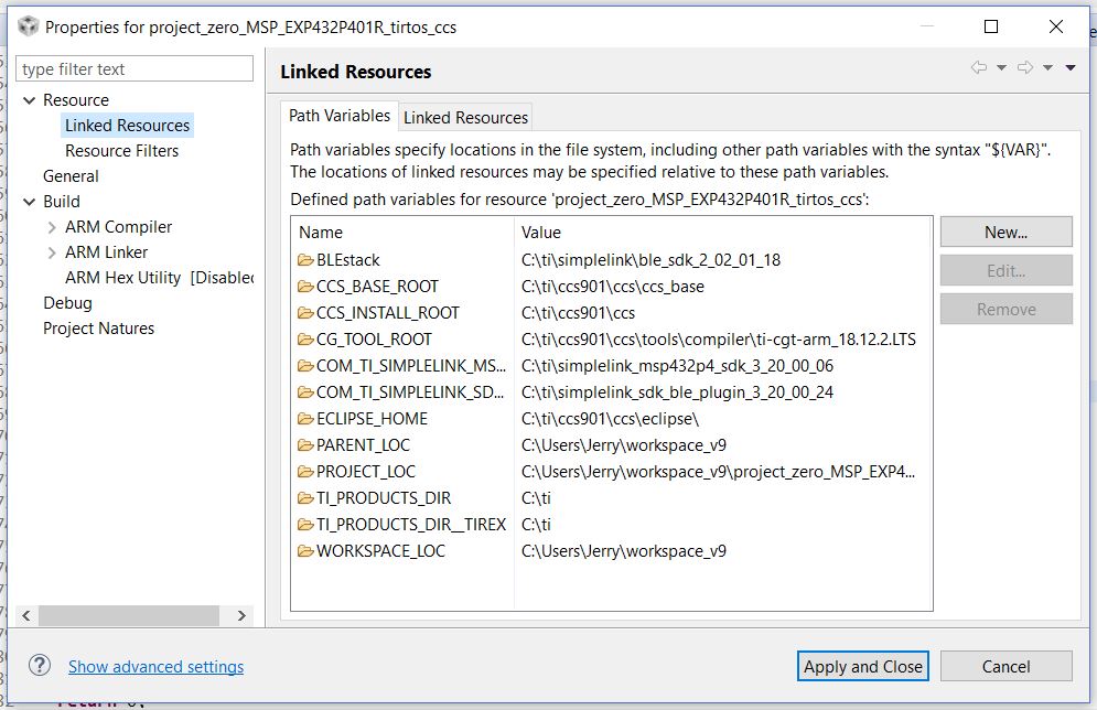

  • Hi Jerry,
    Can you post a screenshot of Project- > Properties -> General -> Resources. In this view you should double-check that CCS is using BLE-Stack 2.2.1 for this project.
  • Thank you for the reply Mary H,
    Is this the proper way to set up the file directory? Sorry if this is an obvious question, I don't have a whole lot of experience using this development platform.
    What I currently have installed is CCS v9, SimpleLink MSP432 SDK, SimpleLink MSP432 SDK plugin, and BLE stack 2.2.1.
    Regard, Jerry

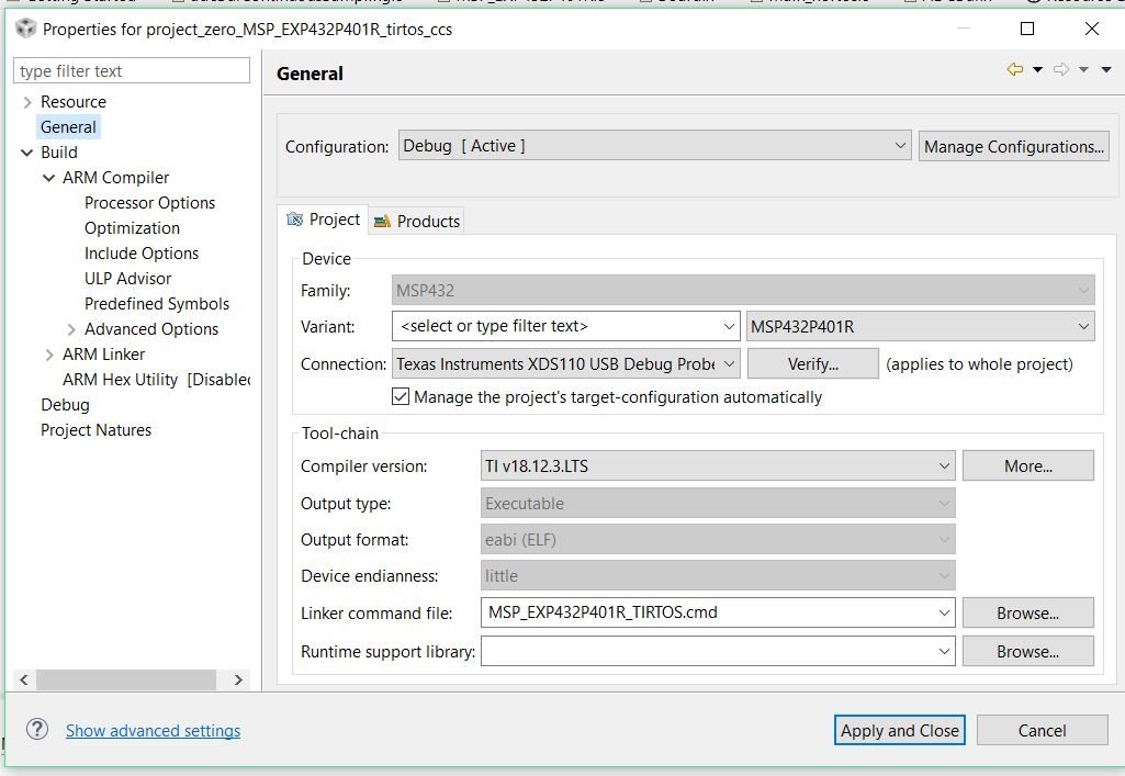

  • Hi Jerry,
    Can you post a screenshot of Project- > Properties -> General?
    Did you install everything to the default location? (C:/ti and C:/ti/simplelink)
  • Hello Marie H,
    Yes, I have all my SDKs and plugins installed on C:\ti and the BLE stack is located in C:\ti\simplelink. My projects are located in C:\Users\Jerry\workspace_v9. Do you recommend I delete the plugin and BLE stack, and reinstall?
    Regards, Jerry
  • Hi Jerry,
    As I am not able to reproduce your issue and you haven't made any code changes, one theory is that something went wrong during your installation. So yes, I would recommend you to re-install the BLE-Stack and the SimpleLink Academy package (to the default locations).
