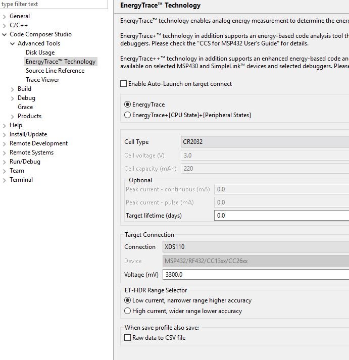

    The fact the standalone EnergyTrace session is simply vanishing is strange - the auto detection mechanism may be somehow failing. It defaults to the MSP-FET connection and, if this pod is not found, it should show the following dialog box:
    In this case, can you go to menu Window → Preferences → Code Composer Studio → Advanced Tools → EnergyTrace Technology and set the connection to XDS110? That would bypass the auto detection mechanism.

    Thanks for your reply. These are the default settings which I haven't seen a need to change. All jumpers are removed as you suggest and my application is such that the tx power requirement of the CC1312R is about the maximum seen as it is a low powered sensor. I am struggling for stability all round with CCS and Energy Trace even when running a program on-board with 4-wire JTAG.
