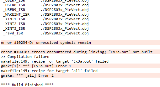

    Thanks again for your reply.  I found that the runtime initialisation of the PIE RAM isn't happening.  Having tried to rectify my code there are names in the const struct PIE_VECT_TABLE which the compiler linker can't find reference to:

    The attached file build log is what I get. I have #include all the header files I could think of. I presume I am doing something more subtle wrongly.
  • Hi Rich,
    Are you receiving compilation errors after building for this? If so can you share a screenshot of the errors?
    Make sure you have all necessary files and includes in your project. See the C2000ware example below to compare your project to, it will have all the necessary files and configurations:

  • Hi Kevin
    Thanks for the pointer to that example.  Here is a sample of the console when it fails:
    The function InitSysCtrl(); is also not recognised so that's probably a strong clue as to what is missing.  I'll let you know how I get on,
    Thanks again, Rich
  • Hi Rich,
    Were you able to get any further in fixing the compilation errors? Looks like you're probably missing source or include files in your project.
    Comparing your project to some C2000ware examples should help you in figuring out what's missing.
    Kevin
