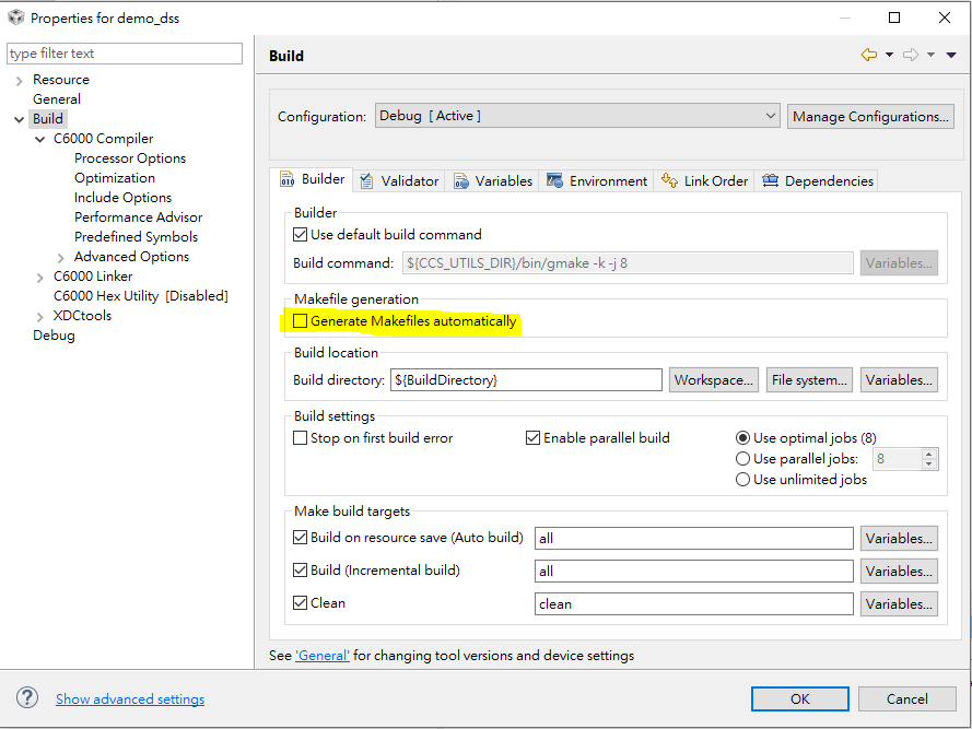

    I find out the problem is that when the setting of project property is changed, the sources.mk file will keep saving this modification EVEN IF the setting is change to default.
    And, this sources.mk affect all project when doing compile
    However, when i uncheck the "Generate Makefiles automatically", the project can be compiled successfully , like following picture
    My question is about why the sources,mk file keep all the modification of project property.
    And it can't be change to default even if the setting of project property is back to default setting
