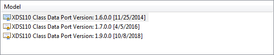

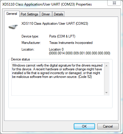

UART of 2640R2F LAUNCHPAD cannot communicate with my computer (Windows 7 Ultimate) .
I can download and debug program with this board, but the UART cannot work.
I don't think what is running on the board matters.
And it works well in my laptop(Windows 10) which use the same CCS installer.
I tried to close the signature verification on my WIN7 PC, but nothing works.
