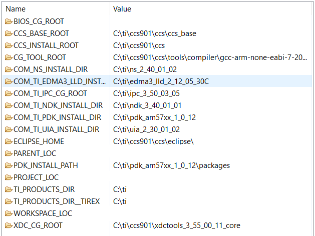

    Does the issue only occur on your platform or does the issue also occur on TI Eval platform. Please indicate how you are booting the SOC. Default SYSBOOT pin setup on the custom board. Are you using GEL files like the ones we provide for TI Evaluation platforms that put the A15 in a clean state post boot. Please also describe if this issue occurs as soon as you load code on the A15 or after you run your application. Can you also try to do a CPU reset after the Gel has run before you load and run code on the A15.
    Also, I noticed from the CG_TOOLS_ROOT in screenshot above that the ARM compiler used in your build is the one that comes with CCS and not the version included as part of the SDK. Please confirm that the version is the same and if not then change the build to use ARM compiler from SDK to see if the issue still persists.

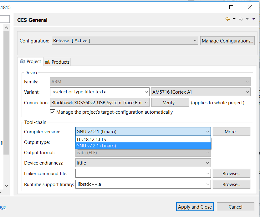

  • HI Rahul
    The compiler used is this one:
    Is GNU v7.2.1 (Linaro) not compatible with the latest SDK?
    Anders.

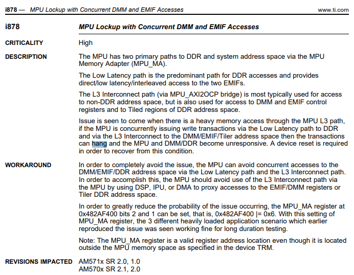

    FYI, we have also tried implementing this workaround, as it seemed relevant:
    Anders.
