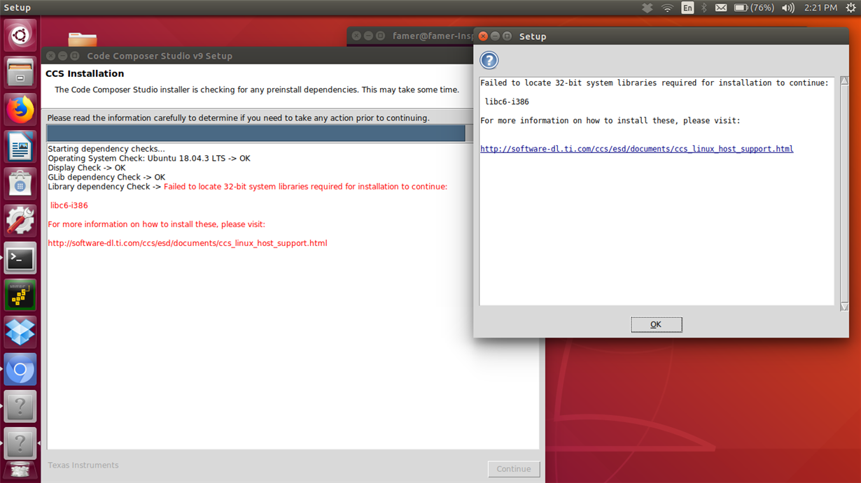

CCS: Can't install CCS9 on Ubuntu 18.04 LTS
I've followed the steps from http://software-dl.ti.com/ccs/esd/documents/ccs_linux_host_support.html but when I run the binary file installation fails because it can't find the 32-bit libc6-i386 even though I followed all the instructions sudo apt install all the dependencies and can see them in my terminal

  • Thanks. That is the same as mine. Strange that the installer is complaining about the missing dependency.
    Can you provide the exact message you see (or screenshot) from the installer?

    I just installed ubuntu 18.04.3 and I hit the same message immediately after booting the system for the first time - i.e., no additional packages on the system.
    It seems that over the years Ubuntu changed the way to designate the i386 packages (several reports on e2e about this).
    When I issue the command shown in the Linux installation instructions using the argument libc6:i386 I get an error.

    Then, issuing the very similar package name libc6-i386, the CCS installer process moves forward.

    From the command line can you issue the command below and see if the libraries are installed?
    cmd said:
    user@test-lab:~$ apt list --installed | grep libc6
    WARNING: apt does not have a stable CLI interface. Use with caution in scripts.
    libc6/bionic,now 2.27-3ubuntu1 amd64 [installed,automatic]
    libc6-dbg/bionic,now 2.27-3ubuntu1 amd64 [installed,automatic]
    libc6-i386/bionic,now 2.27-3ubuntu1 amd64 [installed]
    Hope this helps,
    Rafael
