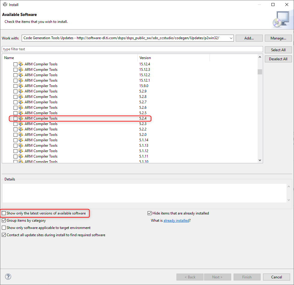

Now I installed a newest version, CCS v.9, but while tring to compile UCD3138A project, I found there is not installed ARM compiler version 5.2.4.
And also I found that when using CCS help-> Install New Software->Code Generation Tool Updates, there is not a v5.2.4 compiler there.
I have read the related forum about this problem and knew that it cuold be solved if  CCS v.6.1.3.00033 would be installed.
But that forum was posted in 2017 and now is 2019.
So I think to ask if there is any other method to solve the compile problem of UCD3138 series ARMs.
