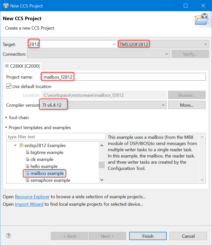

  • Hi Stefani,
    You cannot use that compiler version. I just tried 6.4.12 and it built fine. You can download different compiler versions from here: http://software-dl.ti.com/codegen/non-esd/downloads/download.htm
    We don't recommend just adding a .tcf file. If you are moving a old DSP/BIOS project, it should have had one already.
    You should be able to use Project->New Project Wizard in CCS to create an out of the box DSP/BIOS example. Filter on the device you want, select it, name the project, select the compiler and then the DSP/BIOS example.
    Todd

    Thank you so much Todd!  It compiled and linked!
    The tcf file was already there, from CCS3.3 but then I had to add a couple of lines when I ported it to CCS5.
    Thank you for the example to make "out of the box" project as well.
