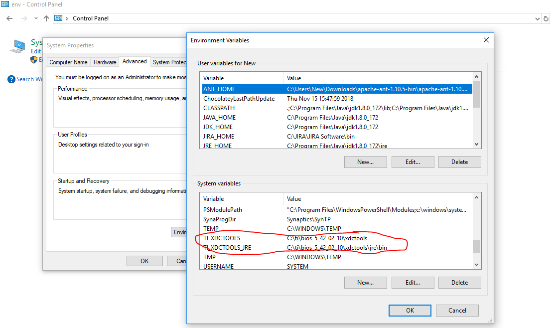

I'm working with TMS320C5535 DSP processor .I have installed CCS V8.2.0. and DSP/BIOS version is 5.42.02.10.
while compiling the audiodemo code im getting an error as C:\ti\bios_5_42_02_10\xdctools\C:/ti/bios_5_42_02_10/xdctools/tconf: can't create session manager: create of JVM failed.(as shown below)
i searched this error in this ti forum also , i got a solution as  i need to add the C:\ti\bios_5_42_02_10\xdctools\jre\bin  path to the environment variables in control panel. i added that path as shown below
but i didnt get any changes when i added that.
and i tried to open the .tcf file but it is not opening as it s telling that unable to create bios config server.
please can any one tell me the solution for this query .i need the answer most

  • Roopa,
    I see that you have added a variable named TI_XDCTOOLS_JRE with the path to C:\ti\bios_5_42_02_10\xdctools\jre\bin. What you need to do is add that path to the system PATH variable.
    Please see this thread and this thread for more information on how to add the C:\ti\bios_5_42_02_10\xdctools\jre\bin path to the system PATH variable. Then restart your computer and try the build again.
