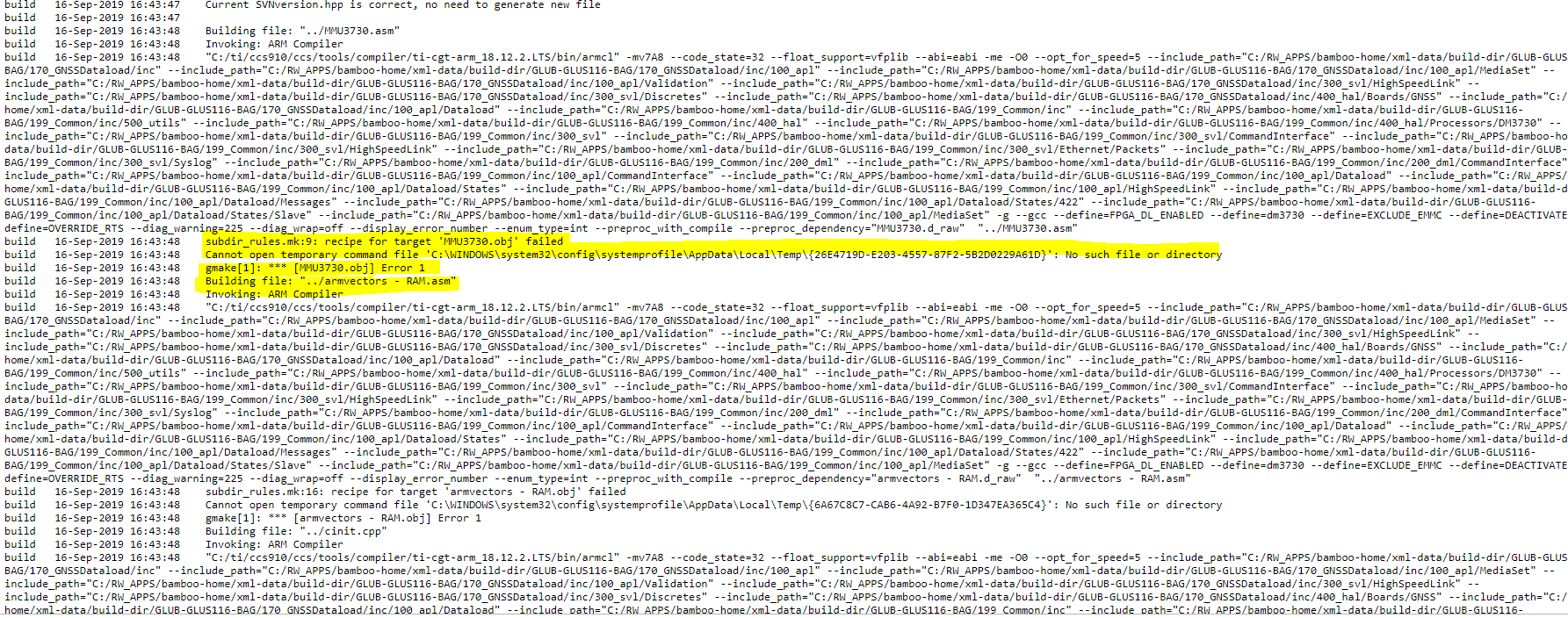

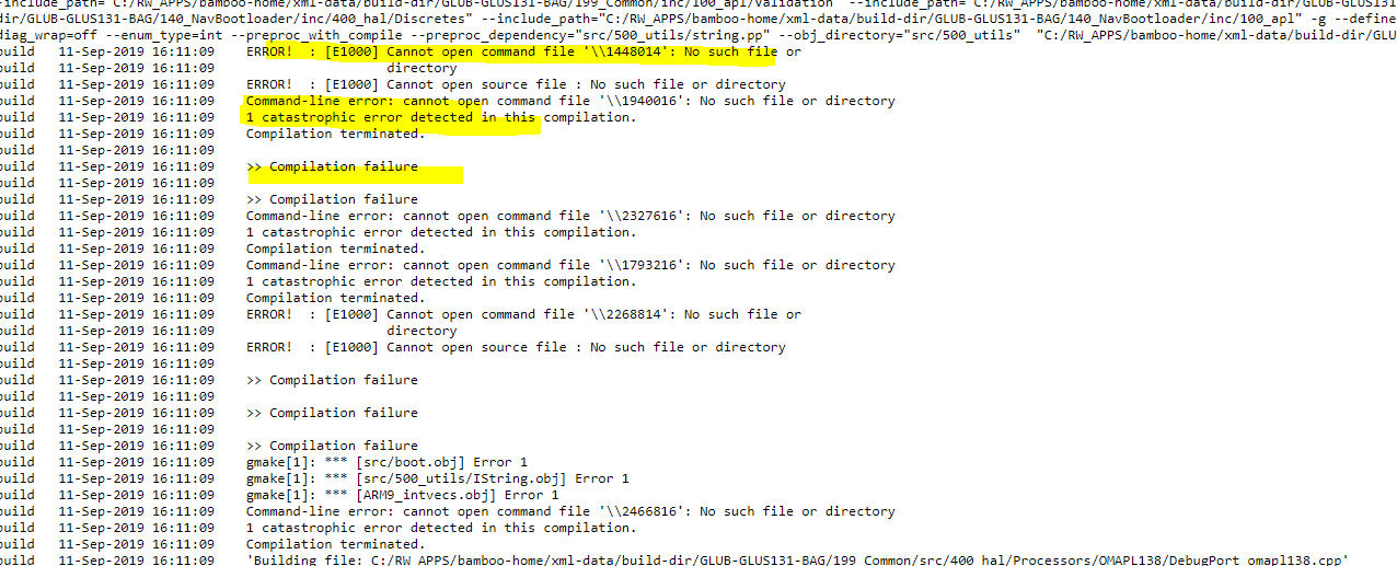

Based on the initial responses we are now using Code Composer 6.1.3 with following compilers c6000_7.4.14 and ti-cgt-arm_5.2.4 on windows 10., but still we are receiving all the errors mentioned earlier and in the snapshot. Any help is greatly appreciated.
  • I'm not sure about the cause of the problem.
    It might be the same one as in this forum thread.  One way to see is to upgrade the C6000 compiler from version 7.4.14 to version 7.4.22.  If that fixes the problem, then you need to upgrade the ARM compiler too.  However, there is no version 5.2.x of the ARM compiler with the fix.  You would have to upgrade to something much later.  That being the case, I recommend you upgrade all the way to the latest long term support release, which at this time is version 18.12.3.LTS.
    If upgrading the compiler does not help ... Use the compiler option --temp_directory=directory_path to have the compiler use that directory for temporary files.  If that helps, then consider changing the environment variable TMP or TEMP to that directory.

  • Hi George,
    I also wanted to mention that when I run our builds directly through code composer 6.1.3 interface with c6000_7.4.14 and ti-cgt-arm_5.2.4 compilers on widnows 10, then everything works perfectly.
    In this case, we are sending build commands to code composer through the ALM Bamboo interface (Continuous integration plan). This is mostly set up using python commands and Tortoise SVN directory. Here our builds are failing with the above error. Do you have any suggestions for that?

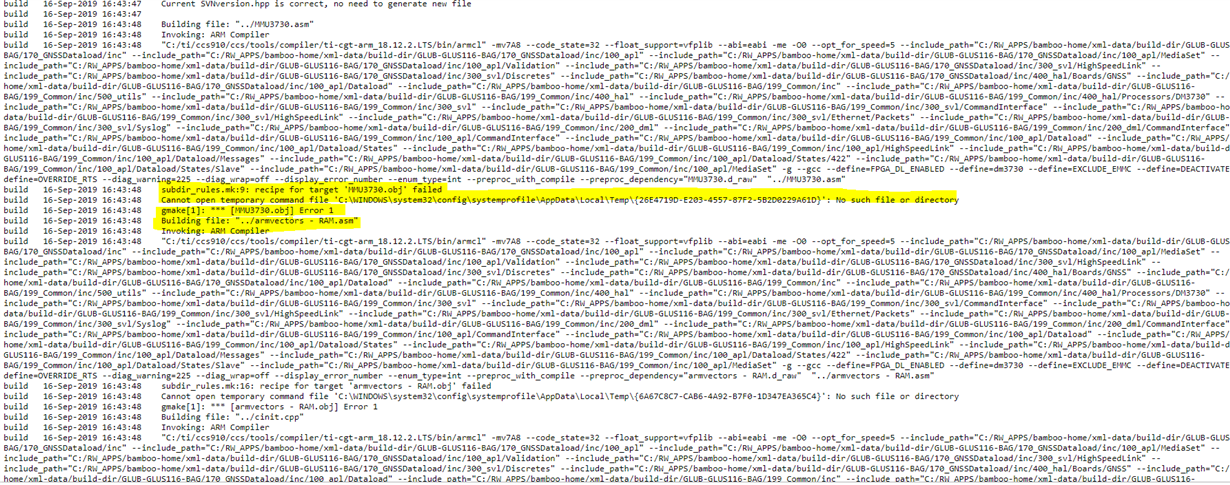

    After all this, we are still getting the attached error. Also, the link that you mentioned seems to have similar issue but I did not quite understand the resolution. Can you please explain that?

  • The root cause turned out to be a network issue in the customer's system.
