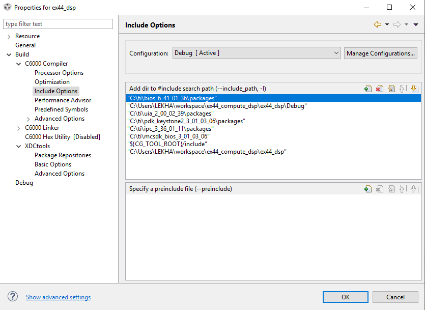

  • Mohan,
    How are you loading the DSP binary? Please ensure you are loading it via Linux and not from CCS. When the DSP image is loaded by Linux, RemoteProc parses the system resources defined in the resource table that is linked into the DSP image, and allocates the rpmsg vring buffers and trace buffer, and configures the DSP MMU. If the DSP image is loaded via CCS, this step will be skipped.
    Can you try getting the example to build in CCS and run successfully without making any modifications to it first? This will help us determine if the issue is due to some missing CCS build setting (compiler or linker options), or due to the changes you've made to the example.
    Sahin

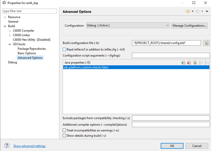

  • Hi Mohan,
    I was able to get the project to build on my end. These are the steps I took:
    1. Create a new CCS project with target: ti.targets.elf.c66 and platform: ti.platforms.evmTCI6638K2K:coreN
    2. Add all files from dsp folder and shared folder
    3. Added package repository paths under CCS project settings > XDCtools > Package Repositories
    4. Added compiler include paths
    5. Added -Dxdc.platform.custom.check=false to XDCtools options
    I've attached the project below for your reference. You will need to modify the XDCtools Package Repositories paths to match your machine.
    ex44_compute_dsp.zip
