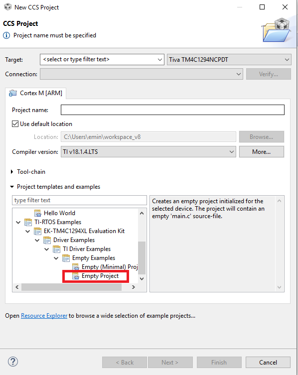

I want to use EK_TM4C1294XL for controlling a high frequency power inverter. I wanted to run some example codes that I have downloaded from the original website of TI. I need some assistance to solve some problems related to Code Composer Studio.
I created an Empty Project in TI-RTOS Example. After that, I have composed a program that simulates a PWM Module. However, I would like to change the system clock setting (Clock_tickPeriod) due to the working principles of the Task_sleep() function that changes the current task's mode from Mode_RUNNING to Mode_BLOCKED, and delays its execution for nticks increments of the system clock, where the actual time delayed can be up to 1 system clock tick less than nticks due to granularity in system timekeeping and the time elapsed per tick is determined by Clock_tickPeriod. So, how can I declare a value for Clock_tickPeriod?
