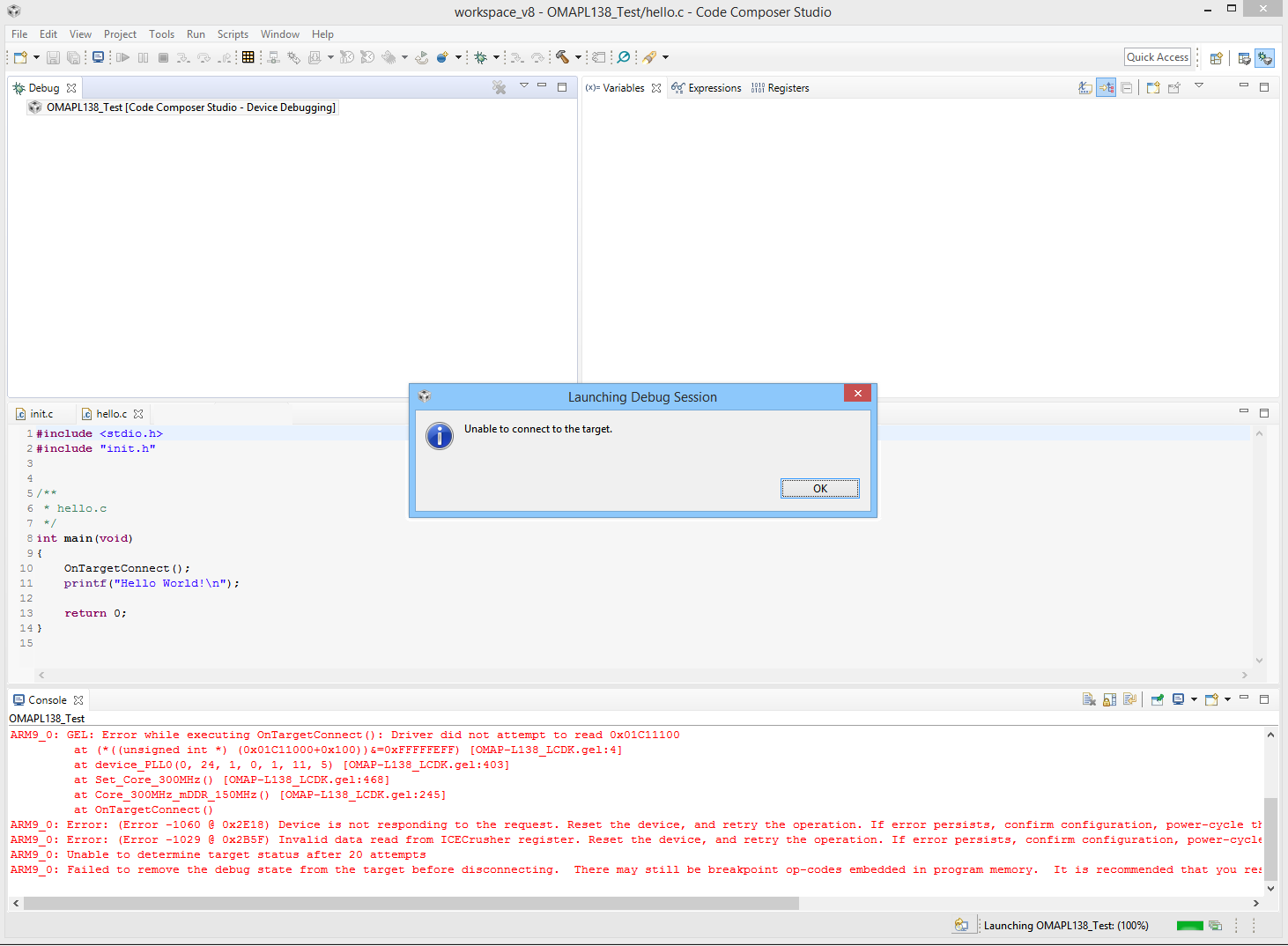

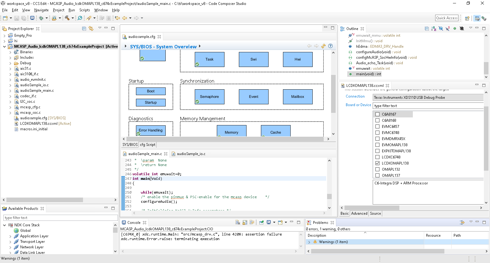

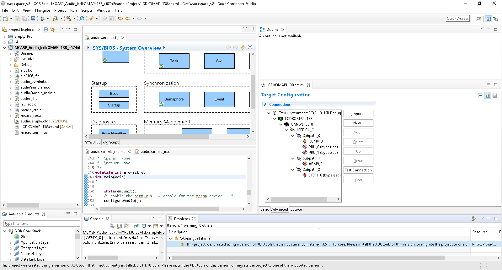

While running project MCASP_Audio_lcdkOMAPL138_c674xExampleProject (export from TI\pdk_omapl138_1_0_6\packages\MyExampleProjects) a run time error occurred almost immediately and program run into exit. The error xdc.runtime.main: "src/mcasp_drv.c", line 4208:assertion failure"
also a warning appeared: "This project was created using of XDCtools that is not currently installed:3.51.1.18_core"
I used XDCtools 3.50.7.20_core/
See screen capture below.

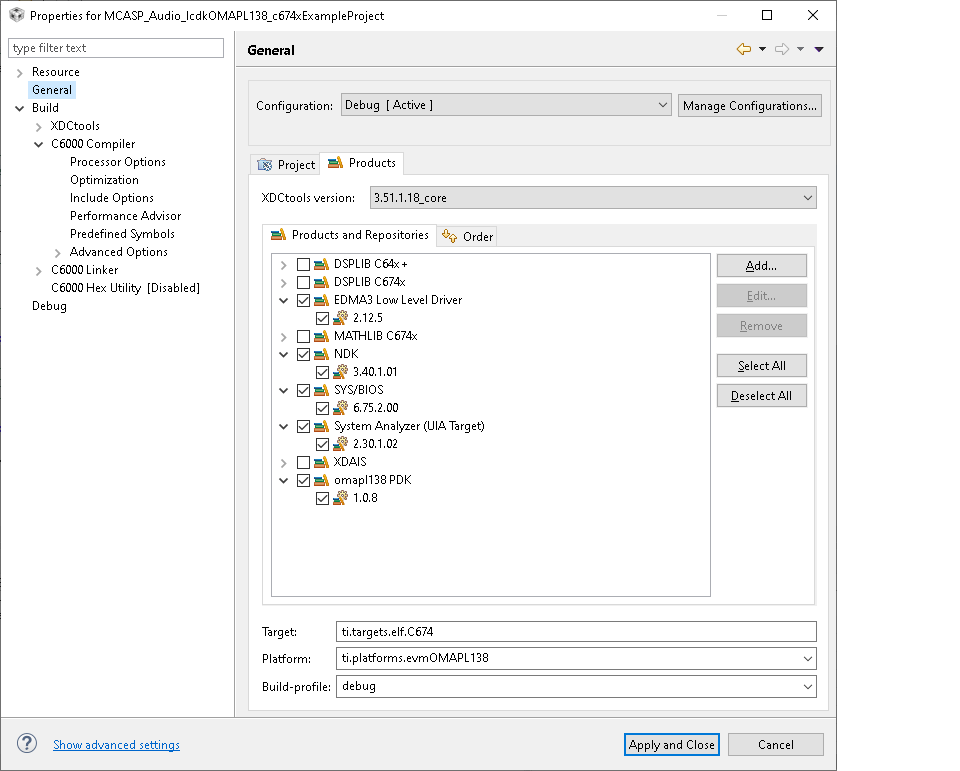

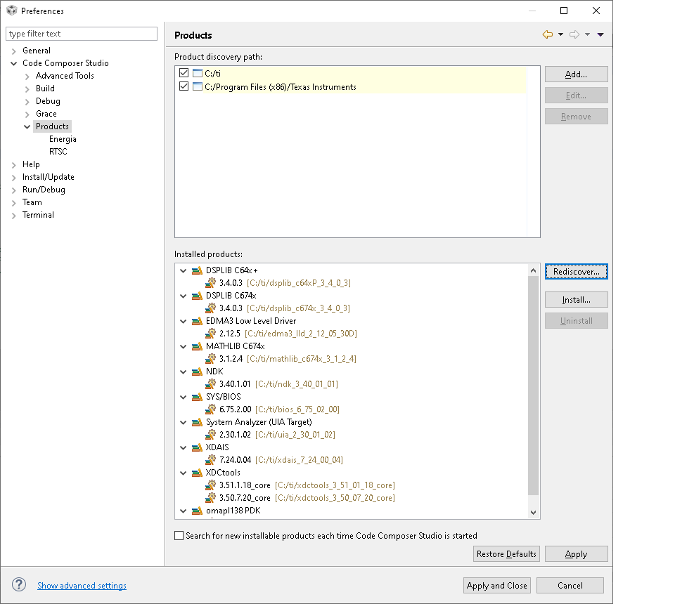

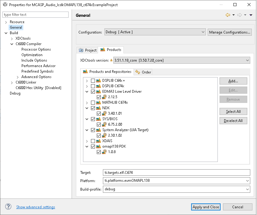

  • Please check the version of Processor SDK RTOS that you have installed and confirm that the BIOS and XDC tools version match with the version in the SDK.
    BIOS and XDC tool versions need to be compatible when you are generating and importing the project in CCS. If the XDCtools version is present in the SDK but not discovered in CCS then you will need to re-run the CCS Discovery step using Windows->Proferecences-> Code composer Studio->Products -> Rediscover

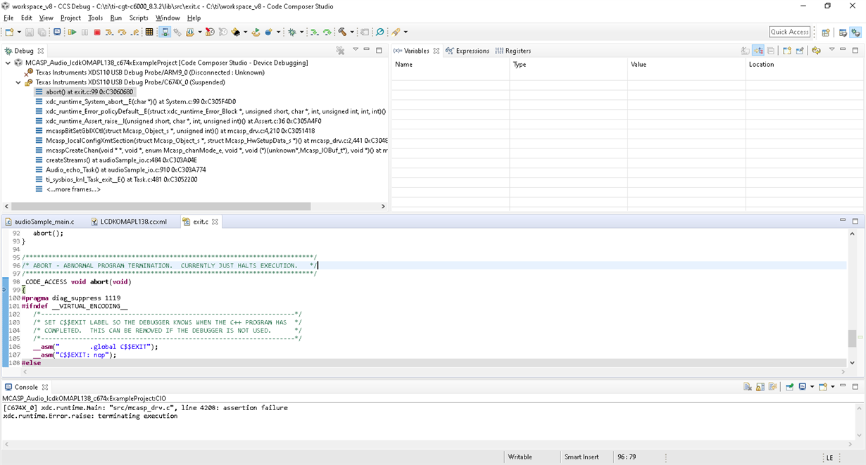

    After installing XDCTools vers 3.51.1.18_core, it still not working and exit of running almost immediately. See  screen capture below:

  • Itzhak Kroin,
    Now that you have the components setup correctly. Can you indicate what your LCDK setup looks like. Have yo setup the boot mode pins to UART and connected to CCS. Please confirm that PLL0 and PLL1 are setup using the GEL files.  Also since you are testing audio example please make sure that you have audio line in and Audio line out connected.
    CCS and LCDK Setup : http://software-dl.ti.com/processor-sdk-rtos/esd/docs/latest/rtos/index_how_to_guides.html#omap-l138-c6748-lcdk-hardware-setup
    McASP Example: http://software-dl.ti.com/processor-sdk-rtos/esd/docs/latest/rtos/index_device_drv.html#id192
    If you go the line number of the assert, you will see that the error occurs when there is timeout when trying to setup the global transmit control register "mcaspBitSetGblXCtl" . If you can put a scope and on the MCASP clock and frame sync pins, you should be able to see if the clock is showing up as expected and the framesync is generated.

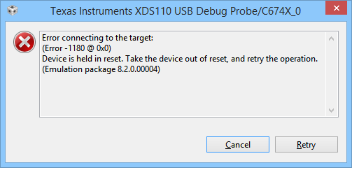

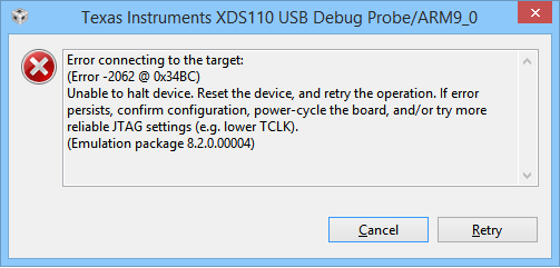

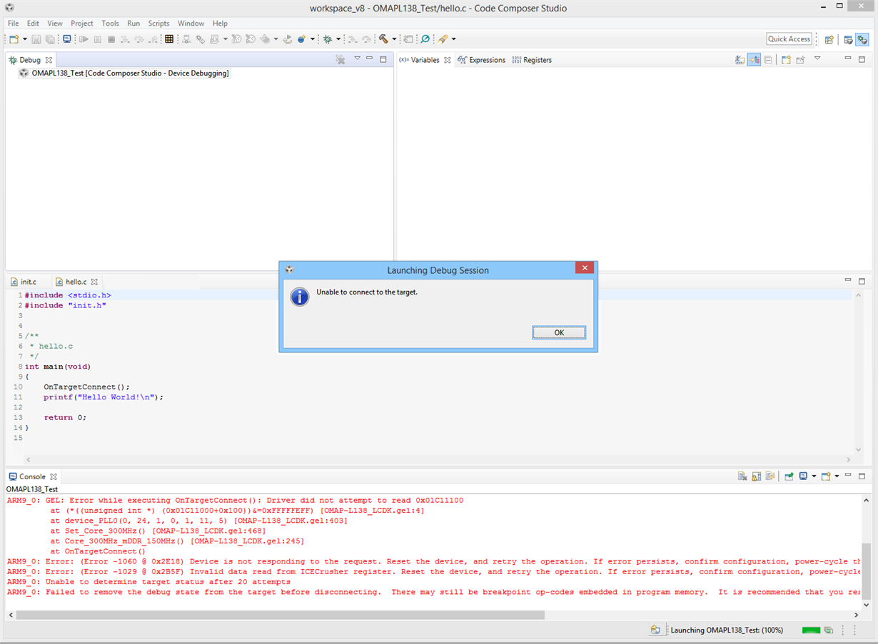

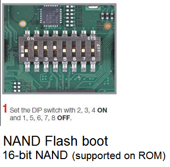

    Following are board boot sw setup and gel init file attached, but I couldn't find where the locations of MCASP clock and frame sync pins on the LCDKOMAPL138 board

    Please change the boot mode pins to UART boot as described here for any debugger based testing. With NAND boot mode the ROM will change the default pinmux setup and there is possibility of boot images changing the initialization.  Also, in the future, I would recommend posting code/GEL as a file here as the post is not readable and hard to follow. On OMAPL138 LCDK, uboot/Linux images are flashed on the NAND by board manufacturer and can interfere with your debug/emulator setup unless you erase the NAND.
     If the issue still persists then we can look at trying to reproduce the issue with the examples source to root your setup.
    Rahul
    First, it seems as a pinmux problem (rem windows-ccs-XDS110 architect.).
    Trying to work with boot mode pins as UART boot (its UART2 on sw1 instead NAND 16) and then RESET (s1 on board) Led D7 lit (in NAND boot D7 was OFF after RESET), then on running debug we got an Error connecting to the target: "(Error -1180 @ 0x0) Device is held in reset. Take the device out of reset, and retry the operation. (Emulation package 8.2.0.00004)".
    At that point, still on debug perspective (and this following while sequence is not quiet clear), setting sw1 back to NAND 16 boot mode and RESET (s1). then manually connect target (ARM) ,Scripts wake DSP, connect target (C674x_0), Load
    Program then run (Resume command) it works! from now on any modification and build its ok (remember it still on NAND 16 boot mode). But next time after exit CCS and turn power off the EVM board and emulator its return to its wicked ways (means assert an error).

    First I would like to mention that I worked with XDS110 DEBUG PROBE that connected to the LCDKOMAP-L138 via J6 (Debug port) and not with terminal window (connected via the USB J3 port).
    While trying boot mode MMCSD, going to debug screen the following error occured:
    Don't know how to take device from reset except wake DSP by ARM.
    Then trying to connect ARM9 we get the following error:
    Changing to NAND 16 boot mode and RESET (s1) and work manually (connect, wake up DSP and Load) some time worked.
    Still it seems that the NAND 16 boot mode is the only one that does not yield error on debug session.
    Please help.

  • Hello Itzhak,
    The ARM9 core uses adaptive clocking which is not supported by the XDS110. The XDS110 loses the ability to properly talk to the device when the register PLLCMD is set to re-lock the PLL - this happens at line 716 of the  OMAP-L138_LCDK.gel.
    The XDS110 is only supported with the C6748 variant of the LCDK as mentioned in Table 2 here: L138/C6748 development kit (LCDK) (Rev. A)
    The current workaround is to convert the GEL initialization routines to C and include them in your project. Please take a look at the following thread for a discussion on this.
    (Refer to Rafael's post for an example project that performs the GEL init in C)

    OMAPL138_Test project is an ARM project while needed DSP project type. Additionally an error raised while running debug (on originally and even after rebuild) as follows:
    Itzhak Kroin
    Please connect to the ARM9 core without running the GEL file. Then load and run the ARM project provided by Rafael to completion - this will perform any HW initialization normally done by the GEL file. At this point, you should be able to connect to the DSP and debug normally.
    The other option is to purchase an XDS100, XDS200, XDS510, or XDS560 emulator to avoid this problem.
