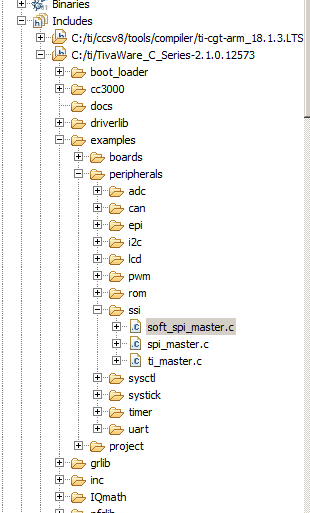

But when i use SSIDataPut(SSI2_BASE, ui8DOTx[ui8Index]);
I discovered that there is no way to force the SPI driver library to change the slave select (Fss) to use another GPIO pin than the first configured.
So is there any solution for this other than using an external hardware?
