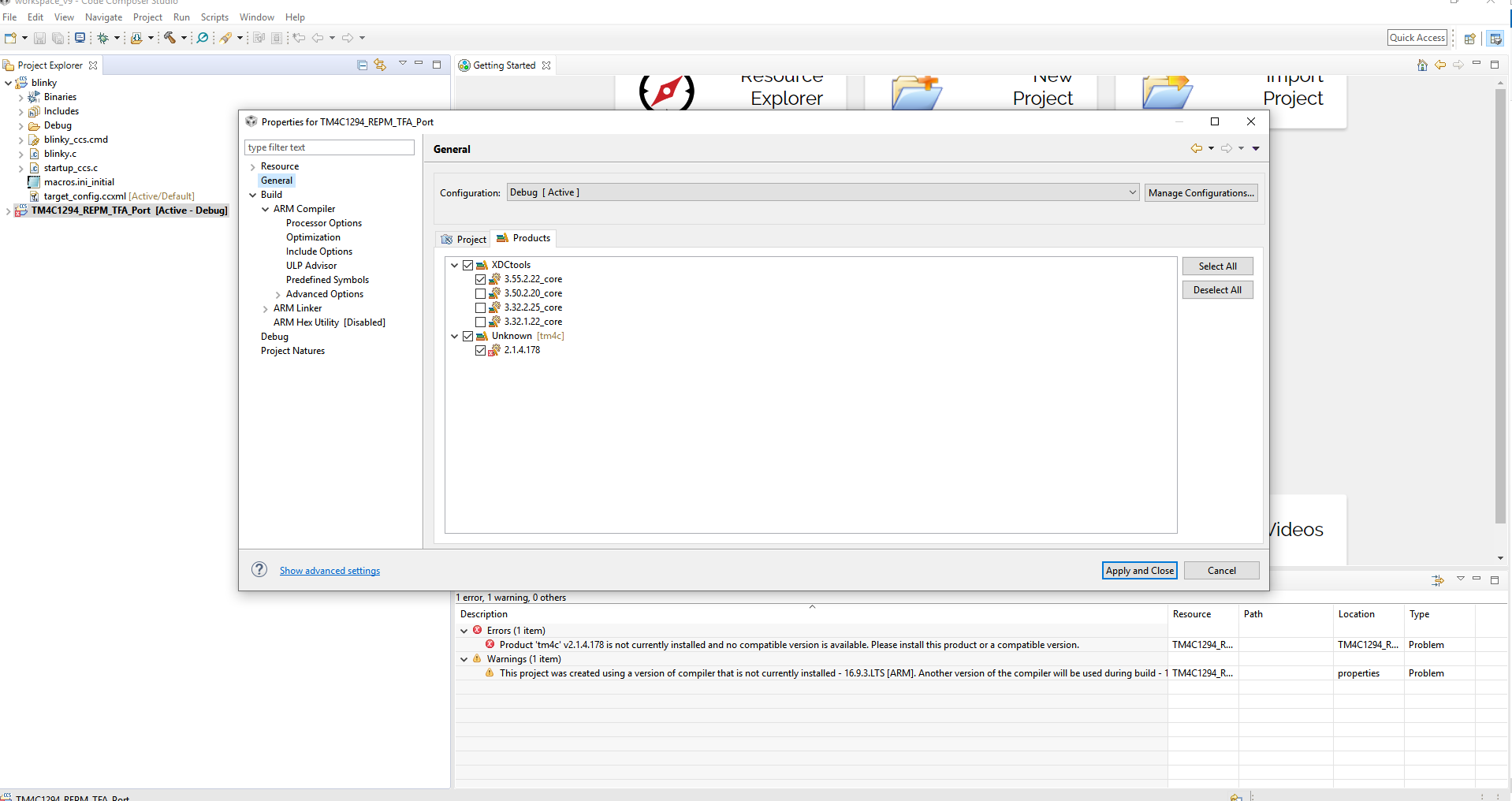

I tried switching up to CCSv9.1. As I understand, this is compatible with windows 10. The installation is not completing successfully. Other than windows firewall, I don't have any other antivirus on my laptop.
Please help me understand why the tm4c product cannot be identified?
Even with the blinky project, the tm4c product does not show up.

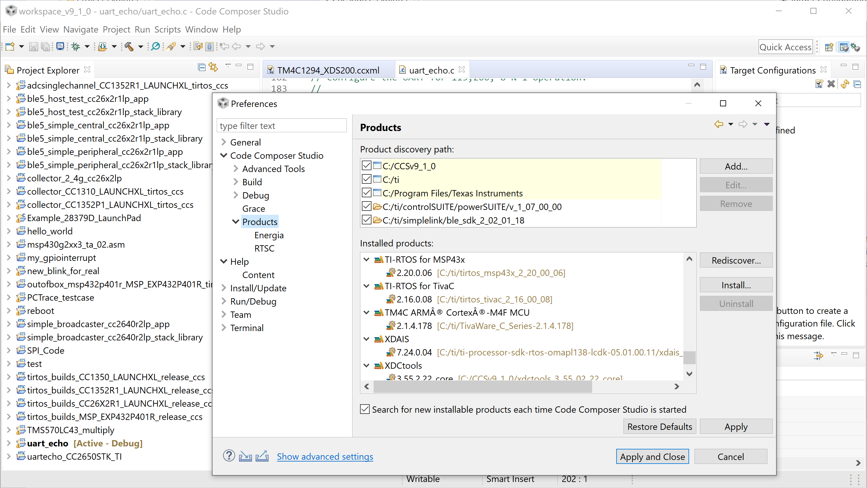

  • Priya,
    The TM4C component is supported and correctly identified by CCSv9.1, therefore it may be a matter of discovering/adding the product to the RTSC category.
    Check the page Product Installation and Selection below, which contains the procedure to add this.
    https://software-dl.ti.com/ccs/esd/documents/ccs_product-installation-selection.html
    Hope this helps,
    Rafael

  • Priya,
    Priya Nadathur70 said:
    Where can I get this?
    It is the first hit if you google for "XDSTools download"
    Would you mind providing some clarification about this? Did you update to CCSv9.1 through the Update notification or did you download CCS, wiped clean the old installation directory and installed the new version? This last method would fully explain why the existing Tivaware "disappeared" from your development environment.
    The reason is that I see from the log that CCS install completed - there is an error at the very end, but I don't necessarily know what this entails.
    Rafael
  • Thank you for your reply. I did not know there was a way to upgrade from
    ccsv7 to ccsv9 without re-installing.
    I am currently working with ccsv8.
    Using the rediscover tools, I was able to get rid of the can't find tm4c error. However,
    with ccsv8, I am now getting can't find driverlib files error and can't find usblib files error
    as well. I have driverlib and usblib linked to the project directory. Any pointers on making
    this go away is appreciated.

  • I have now passed through compilation successfully by adding the correct links for include options.
    I am however not linking successfully.
    In my past ccsv7 setup there was a variable called $COM_TI_TM4C_LIBRARY_PATH
    Is there an equivalent of this in ccsv8?
    I have these two paths in the file search path, but they don't work.
    ${TI_PRODUCTS_DIR}\TivaWare_C_Series-2.1.4.178\driverlib\ccs\Debug\driverlib.lib
    ${TI_PRODUCTS_DIR}\TivaWare_C_Series-2.1.4.178\usblib\ccs\Debug\usblib.lib
  • Seems like the nightmare has ended. I added links to usblib.lib and drverlib.lib and the build completed. Thank you
