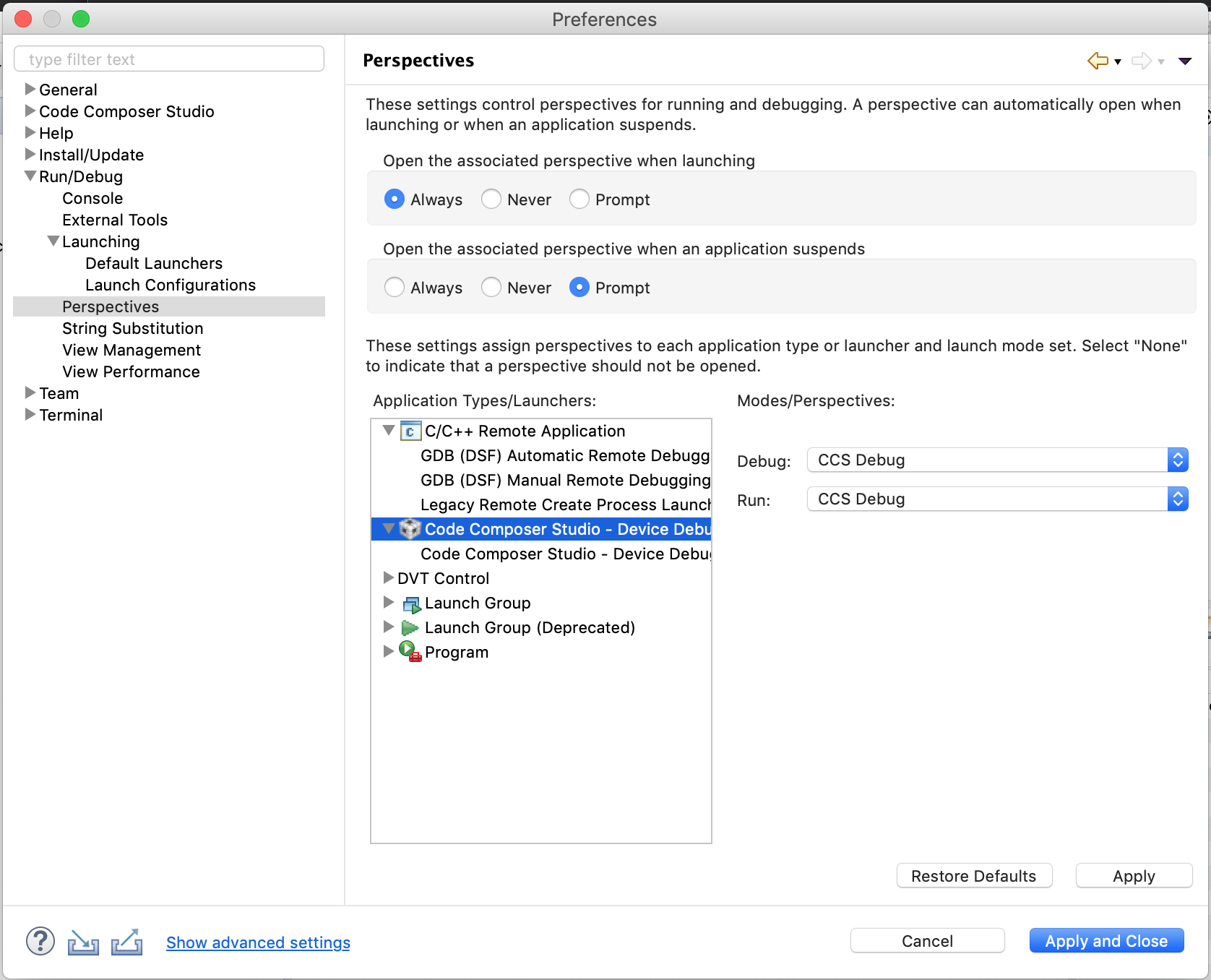

    By default CCS will use 2 perspectives: CCS Edit and CCS Debug.  When you launch a debug session it switches automatically to the CCS Debug perspective.
    I think what you would like is to have a single perspective for both Edit and Debug.  I am guessing that you have saved these settings in either the CCS Edit perspective or your own custom one.
    You are able to control this behaviour.
    In the preferences dialog you can change the seeing to not open the associated perspective.  Or you can also specify for it to open a different perspective.
