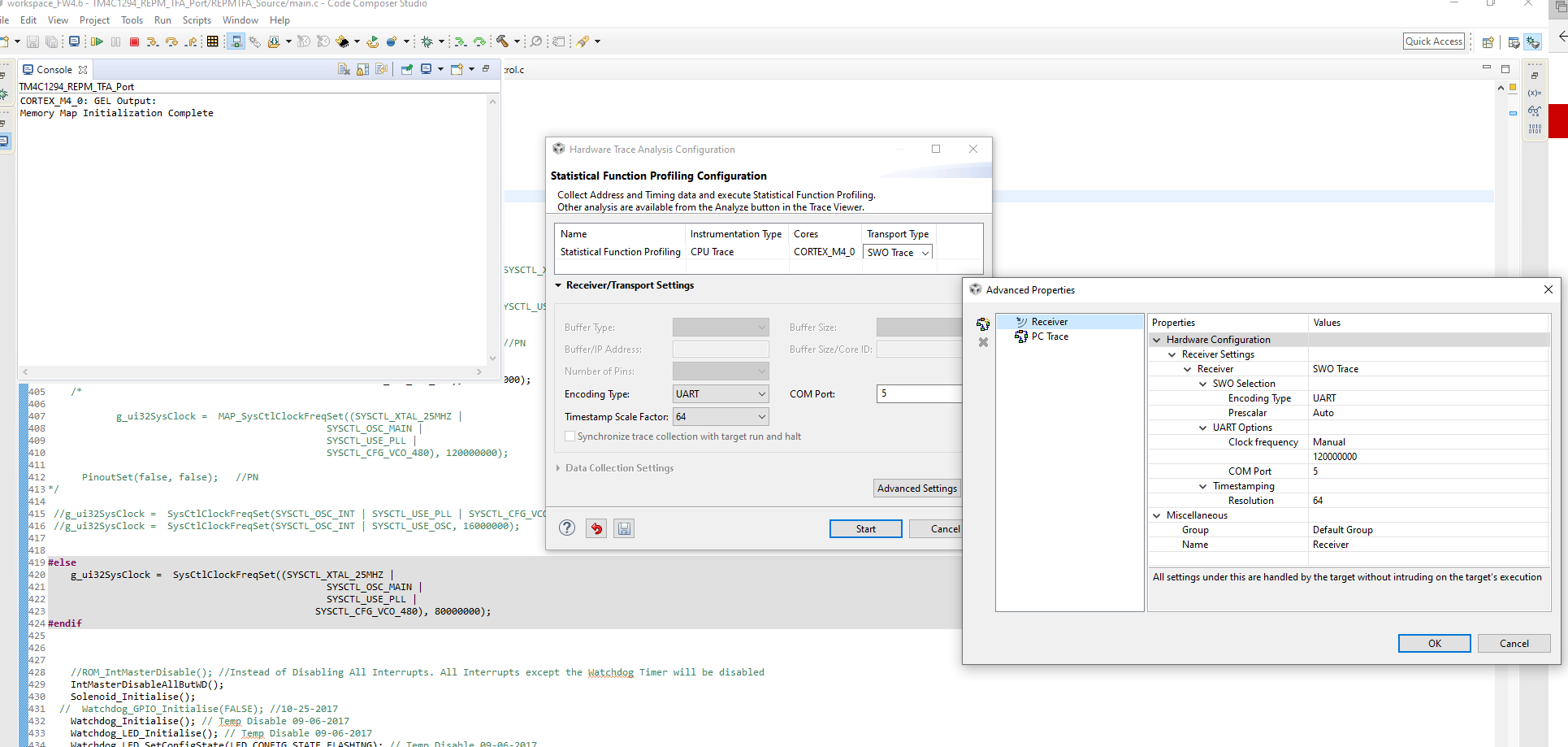

I am using CCSV8.3.1.00004, XDS200 debugger SWO trace.
I need to understand setting up the hardware trace analyzer and using:
Statistical function profiling
Interrupt Profiling
Attached are screeshots to set up these two methods, they seem identical. I don't see a tab to set the sampling CLK.
Why is this? Where can I find this?
I am using resolution of 64. Is this ideal. I am still seeing OVERFLOWS happen when I interrupt profile 19000 out
of 1.4 million records. How to eliminate this?
How do I change the UART prescalar value? Will this help with the overflow issue?

  • Priya,
    Please apologize for the delay. I am able to collect data from a simple example program (interrupts) without the overflow happening. Please check the short clip below, with settings and such.
    As I mentioned in your other thread, the sample interval must be increased to reduce the data throughput - that is the most effective way to control the data flow and avoid the overflow messages.
    A while ago a user and I experimented with the UART settings and reported this on the thread below. As you can tell from there, a minimum sampling interval can remove the overflow conditions.
    https://e2e.ti.com/support/tools/ccs/f/81/t/677821
    As you mentioned, the prescalar will affect the data throughput as well, but that is a lot more tricky to get it right as it may overflow the buffer on the target (the UART becomes too slow to empty the buffer on the device), thus losing samples.
    Regarding the inoperative Trace, I would remove all teh Trace temporary files - close CCS and then delete the directory C:\Users\user\.TI-trace
    At last, I would double check system-wide issues such as other processes running, which may cause either the UART or CCS itself operate at a lower speed.
    Hope this helps,
    Rafael
  • Edited to add: I updated emulator software. The problem below is still there.
    The target is TM4C1290NCPDT, I'm using CCSv8.3.1
    Today, I was able to start the HDWTrace analyzer with statistical function profiling once. The PC value was the same the entire trace, the ticks seemed to increment correctly.
    Since the first time, I repeatedly get errors It says it is unable to select the receiver. Please check target config.
    I am in SWD mode with COM port connected to TDO, JTAG integrity test passes OK.
    Deleting the workspace and restarting CCS; power cycling the hardware, disabling autorun doesn't seem to help. This error happens following initializing the hardware trace analyzer.
    If I am not using SWD mode, just regular JTAG mode, things seem OK.
  • Upgraded to CCS9.1.0. Changed JTAG CLK to 8MHz. Hardware trace analyzer is not asking to initialize and statistical function profiling won't start. Same error as above.
