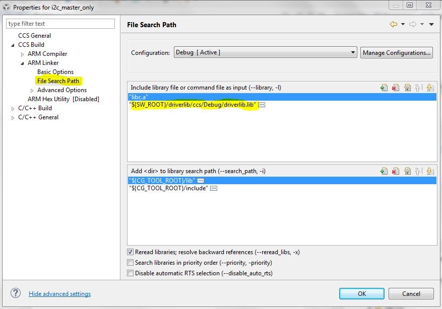

Hi, all.
I am trying to globally enable/disable interrupts in a new project. As I understand the functions IntMasterEnable() and IntMasterDisable() to the work. I included the file "interrupt.h" contains the prototype of the function defined in "interrupt.c". I also included the file "hw_types.h" as suggested in the Tivaware user's guide. However, I always get the error
undefined first referenced
symbol in file
IntMasterDisable ./hello.obj
What additional step should I perform to be able to use these functions? Or, Is there another method to globally enable/disable interrupts?
Thank you.
