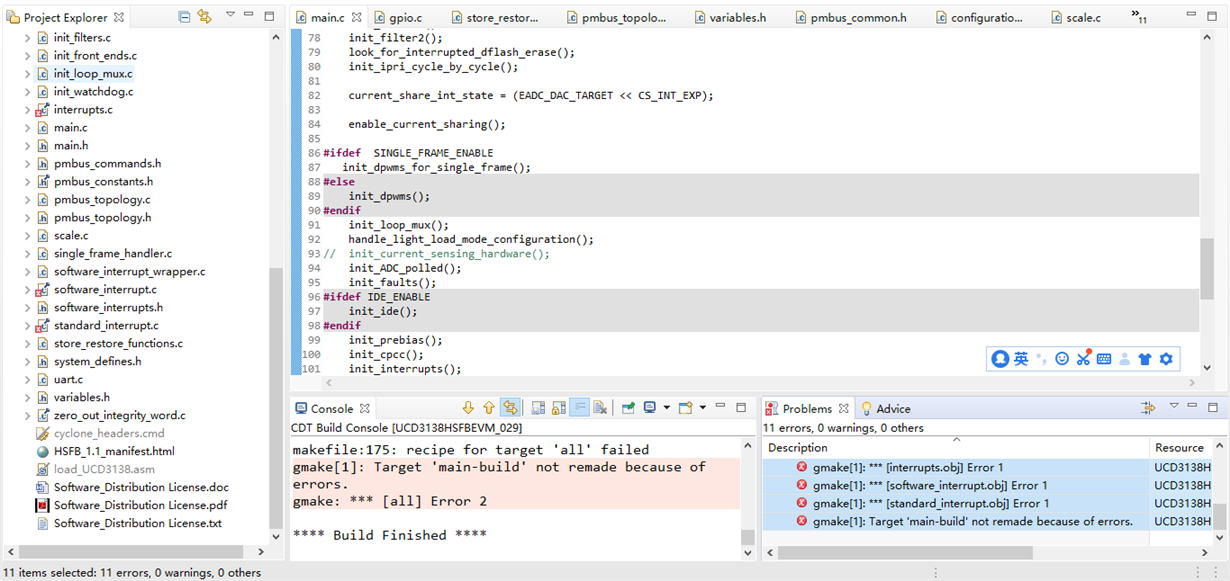

And I built the program "UCD3138HSFBEVM_029", but there were several errors as following:
Description Resource Path Location Type
#1559 Interrupt handlers must be compiled in ARM mode interrupts.c /UCD3138HSFBEVM_029 line 9 C/C++ Problem
#1559 Interrupt handlers must be compiled in ARM mode interrupts.c /UCD3138HSFBEVM_029 line 14 C/C++ Problem
#1559 Interrupt handlers must be compiled in ARM mode interrupts.c /UCD3138HSFBEVM_029 line 21 C/C++ Problem
#1559 Interrupt handlers must be compiled in ARM mode interrupts.c /UCD3138HSFBEVM_029 line 28 C/C++ Problem
#1559 Interrupt handlers must be compiled in ARM mode software_interrupt.c /UCD3138HSFBEVM_029 line 11 C/C++ Problem
#1559 Interrupt handlers must be compiled in ARM mode standard_interrupt.c /UCD3138HSFBEVM_029 line 591 C/C++ Problem
gmake: *** [all] Error 2 UCD3138HSFBEVM_029 C/C++ Problem
gmake[1]: *** [interrupts.obj] Error 1 UCD3138HSFBEVM_029 C/C++ Problem
gmake[1]: *** [software_interrupt.obj] Error 1 UCD3138HSFBEVM_029 C/C++ Problem
gmake[1]: *** [standard_interrupt.obj] Error 1 UCD3138HSFBEVM_029 C/C++ Problem
gmake[1]: Target 'main-build' not remade because of errors. UCD3138HSFBEVM_029 C/C++ Problem

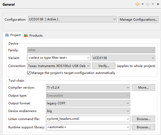

Then,I found a solution :
https://e2e.ti.com/support/tools/ccs/f/81/p/812131/3005647?tisearch=e2e-sitesearch&keymatch=Interrupt%25252525252525252520handlers%25252525252525252520must%25252525252525252520be%25252525252525252520compiled%25252525252525252520in%25252525252525252520ARM%25252525252525252520mode#3005647
Though,I downloaded compiler v5.2.4 and used it ,there were the same problems as mentioned above.

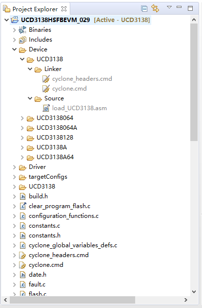

And next I compiled three files in 32 bit ARM mode -- "software_interrupt.c", "standard_interrupt.c","interrupts.c":

in order to solve these compile errors,I found a new way to solve  the problems:
I downloaded "CCS6.2.0.00048_win32" to install and used  compiler v5.2.4:
 I built this program again, it's the the same problem:

This project is currently in 'manual' Parser Preprocessing mode - no dependency graph is automatically generated. This mode should only be temporarily used to generate various pre-processor listing files. Please switch the Parser Preprocessing mode back to 'automatic' for you regular builds. UCD3138HSFBEVM_029 properties Problems
Please help me !And what should  I do?
  • I found one way to solve it's errors,The specific steps are as follows:
    1. choose "Generic ARM7 Device", note:  Link command file choose nothing.
    2. Make sure the Linker  files are not "Exclude from build" and Source file is not "Exclude from build" .
    Note: "cyclone_headers.cmd","cyclone.cmd", "load_UCD3138.asm" these three files which are copied in the workspace should  "Exclude from build"
    Here are snapshots:
    3. Choose "interrupts.c","software_interrupt.c","standard_interrupt.c" these three files to compile in 32-bit mode.
    4. Buid the project.
    Although this methods can avoid errors,it still make some errors when we choose Variant as UCD3138 .
    For example , we choose Variant as UCD3138  and then we have to choose Link command file and Connection device:
    Next ,choose  Linker  files  "Exclude from build" and Source file  "Exclude from build" :
  • Continued :
    Note: "cyclone_headers.cmd","cyclone.cmd", "load_UCD3138.asm" these three files which are copied in the workspace should  not "Exclude from build"
    Finally, Choose "interrupts.c","software_interrupt.c","standard_interrupt.c" these three files to compile in 32-bit mode and build it.
    There maybe some erorrs that remind you your memory is not big enough or something is unresolved.
    Up to now ,I just solved memery error by change my "cyclone.cmd" ,and just left the other errors :
    #10234-D null: unresolved symbols remain UCD3138HSFBEVM_029 C/C++ Problem
    errors encountered during linking; null: errors encountered during linking; UCD3138HSFBEVM_029 C/C++ Problem
    gmake[1]: *** [UCD3138HSFBEVM_029_UCD3138.out] Error 1 UCD3138HSFBEVM_029 C/C++ Problem
    unresolved symbol $c_int00, first referenced in ./load_UCD3138.obj UCD3138HSFBEVM_029 C/C++ Problem
    What‘s Wrong?!
  • I finally found the way to deal with the last errors,choose "ELF" in Output format  insdead of  “COFF",
    Then we can see there is only one warning:
    #10247-D null: creating output section ".data" without a SECTIONS UCD3138HSFBEVM_029 C/C++ Problem
    This warning can be simply solved by modify the .cmd file.
