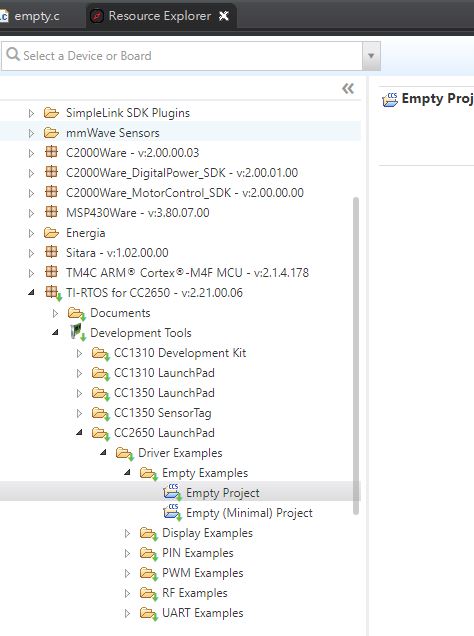

I'm Import "Empty Project" From Resource Explorer & Run it in my cc2650 board , it work very well !

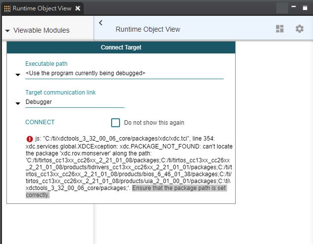

but when i Debug & Open Runtime Object View, it have error.....
Can I use ROV on LAUNCHXL-CC2650?

Hi Wing,
The newer ROV tool needs XDCtools 3.50 or higher. The version of TI-RTOS is not compatible with the newer versions of XDCtools though. So you need to use ROV Classic instead. It shows the same basic data, but just not as nicely.
