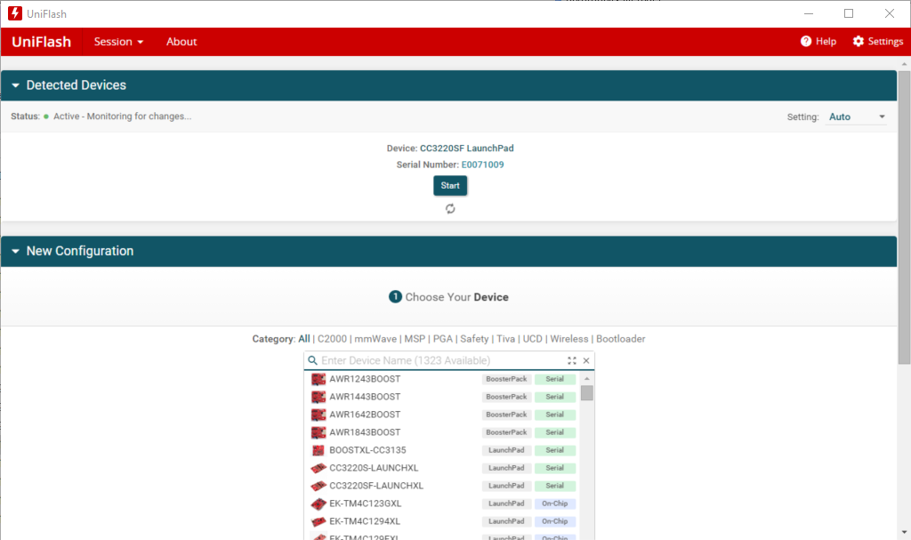

Hi!
I'm trying to connect a CC3220SF-LAUNCHXL to CCS. Seems like I have connection when I'm testing connection in Target Configuration, output bellow.
But when I try to connect to target this error occurs:
CS_DAP: Error connecting to the target: (Error -1170 @ 0x0) Unable to access the DAP. Reset the device, and retry the operation. If error persists, confirm configuration, power-cycle the board, and/or try more reliable JTAG settings (e.g. lower TCLK). (Emulation package 8.3.0.00003)
