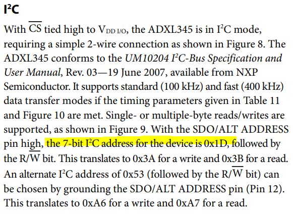

I want to use I2c protocol using ADXL345. I am not able to get the proper output .I have attached the code below if any changes let me know

#define ACCEL_SLAVE_ADDR 0x53
