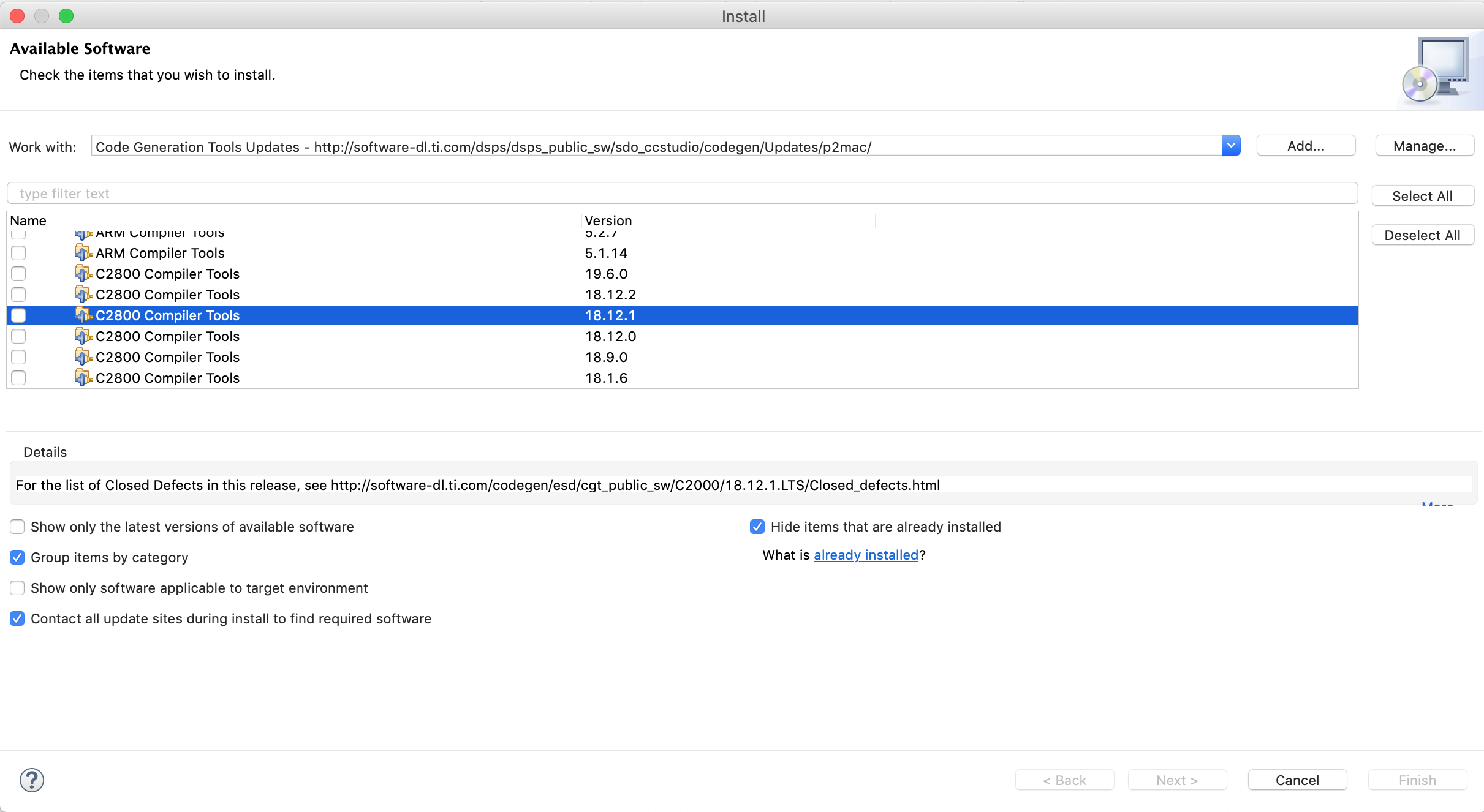

  • Shiva,
    The project you are attempting to import requires you to have a compiler that is compatible with 18.12.1.  Did you install the C2800 18.12.1.LTS compiler?  You can do that by going to "Install New Software" on the Help menu.  Select the Code Generation Tools update site.  Make sure that "Show only the latest version" is NOT checked at the bottom.  Select the C2800 18.12.1 compiler and install it.
