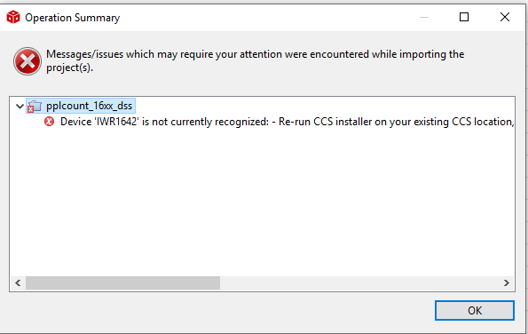

Hi there,
I am trying to implement counting people Demo using AWR1642 via CCS, but i am not able to import or to find the proper file for the awr1642's project from CCS via industrial-toolbox ( all of files besides IWR1642 !!)
Could you assist me to solve this issue.
Mohamad
  • Mohamad,
    Basically this means that your CCS does not have support for IWR1642 installed.  When installing CCS you need to select mmWave Sensors.  You can run the CCSv9.2 installer again and point it to your existing installation.  This will allow you to update your existing install.  Then choose mmWave Sensors on the device support selection page.
    John
