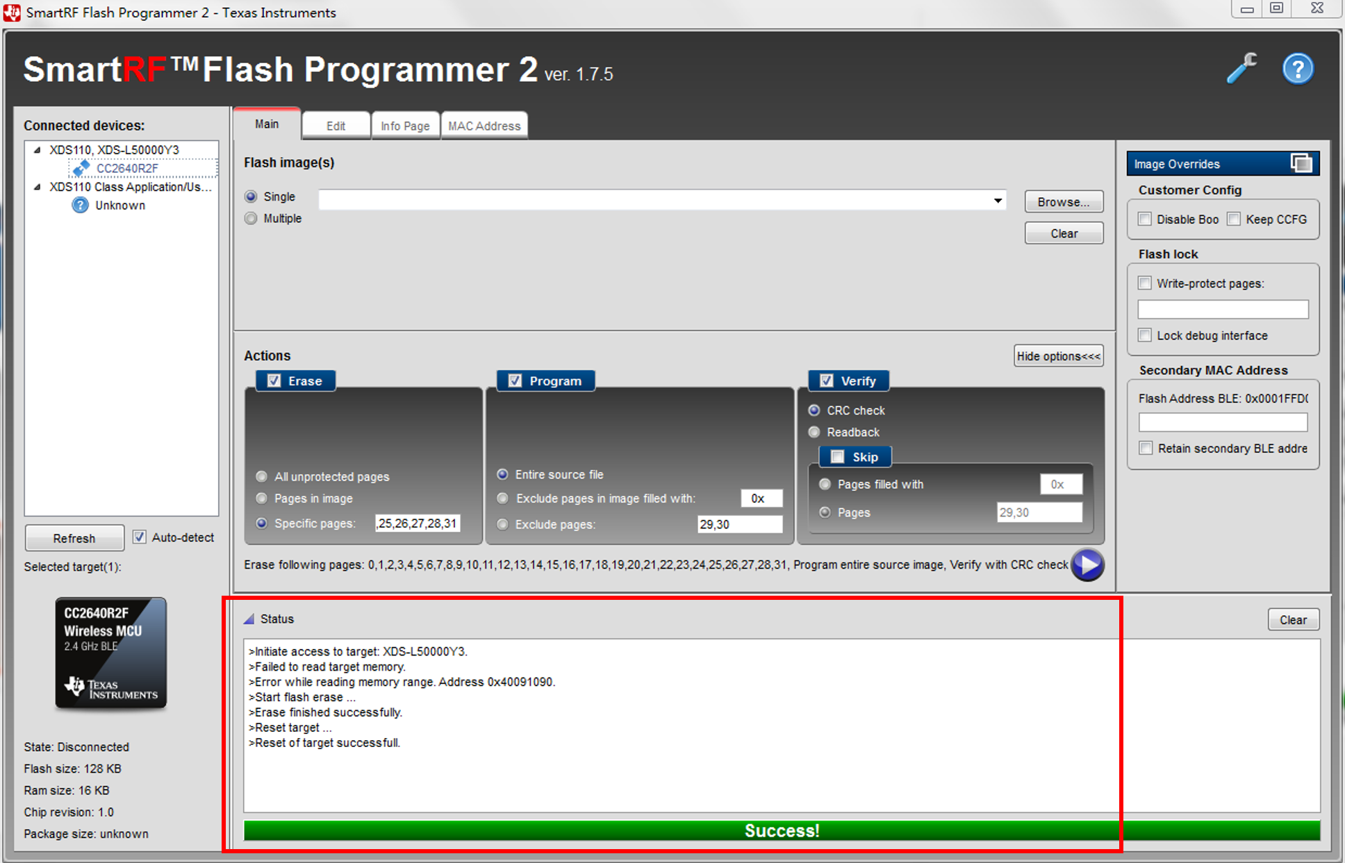

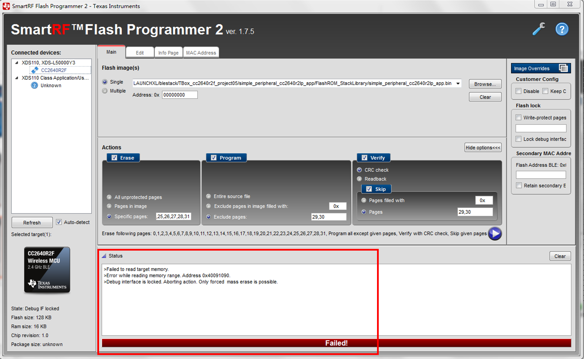

    My debug interface of CC2640 is locked , as shown in picture 1 .
    The CC2640 was programmed with my own bootloader programme . The serial port is UART ,and the bauderate is 115200. However , after more than 100 times of flashing , the debug interface of CC2640 is locked . In order to unlock the debug interface , the latest smart flash programmer was installed , as shown in picture 2 .
    How to unlock the debug interface with smart flash programmer ?
picture 1
picture 2

  • Have you checked what the CCFG section was set to in the last hex file you used for flashing?

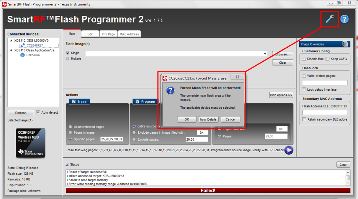

    Picture 1 shows a pop-up that ask you to do a forced mass erase. Did you do this?
    Picture 2: It's not clear when you get what you get in this picture. If you get "unknown" and have a board connected you have bricked the device.

    The debug interface of CC2640 is locked after several times of flashing throuth UART bootlaoder . In order to unlock the debug interface , the smart flash programmer shows that it can be unlocked by mass erasing . However , after mass erasing of CC2640 , the debug interface is still locked and the smart flash programmer cannot connect with CC2640. My detailed steps is shown below:
    (1)configure settings
           Deselect “disconnect after finished ” and “use 2-pin cJTAG”, as shown in picture 1.
    picture 1
    (2)execute mass erase
           Select the CC2640 forced mass erase , as shown in picture 2 . The mass erase is successful as shown in picture 3 . The log of mass erasing is shown below:

    (3)smart flash programmer connect with CC2640 again
           After successful mass erasing of CC2640 , connect the smart flash programmer with CC2640 again . However , the connection failed again , as shown in picture 4 . The log of connecting is shown below:
    >Failed to read target memory.
    >Error while reading memory range. Address 0x40091090.
    >Debug interface is locked. Aborting action. Only forced mass erase is possible.
    picture 4

  • Hi Heng,
    I merged your two threads.
    When you programmed the board through the boot loader, did you also program CCFG (the last flash page)?
    Fredrik
  • The CCFG in the last page was programmed too when I program CC2640 throutg bootlaoder  . My configuration can be got in ccfg.c file which can be downloaded from here last post .
  • - Mass erase will always return status success regardless of the actual status of the command. The mass erase command only sets a bit. If the CCFG is set to prevent a mass erase the erase will not be done. Hence to see if a mass erase has been done, you should always try to read the flash afterwards and confirm that the content is set to only 0xFF.
    Do you always use the same .hex file (since you have successfully flashed the device more than 100 times)
  • When erasing the last flash page with CCFG, the ROM flash driver will automatically re-write the lock bits to "0" after the erase. If there for some reason is a power glitch occuring exactly at the wrong time (the wrong time being after the erase, before the fields are re-written), the device may lock up.
    Have you verified that there is no potential for power glitches in your setup?
  • 1.About reading the flash
            I cannot read the flash of CC2640 , whose debug interface is locked . Hence there is no way to confirm whether  the content of CCFG related to erasing is 0XFF or not .
    2.About .hex file
            I always use the same .hex file .
    3.About unlocking the debug interface
            Is there another way to unlock the CC2640 ? It seems that the smart flash programmer can not unlock the debug interface of CC2640 .
  • If the mass erase disable lock bit is set (by accident), there is no way to recover the device.
    Fredrik

    https://e2e.ti.com/support/tools/ccs/f/81/t/849307
  • If you have set the wrong bit in the CCFg you would see that the debug interface is locked 100 % of the time, not 3 %.
  • Hi Heng,
    I merged your new thread into this one to keep everything in one place.
    No, write protection the various flash pages will not block the debug interface.
    The ONLY way to make the chip unrecoverable is to clear the Chip Erase and Bank Erase fields in CCFG.
    By the way, have you tried Bank Erase through the bootloader?
    Fredrik

  • Hi Heng,
    Refer to the Technical Reference Manual for details on CCFG fields.
    Fredrik
  • I have read the cc2640 technical reference manual carefully . However , the mass erase disable lock bit cannot be found . Only the chip erase disable bit can be seen , as shown in picture 1 . Does the mass erase disable lock bit mean chip erase disable bit ?
    picture 1
  • Hi Heng,
    That is the same thing.
    Fredrik
