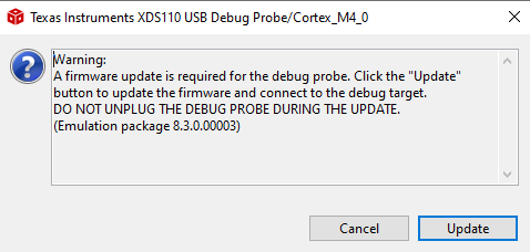

I work on LAUNCHXL-CC1312R1 (chip revision E)
I use Code Composer Studio 9.2.0.00013 and Sensor Controller Studio 2.5.0.84 (patches 1,2,3)
I have a problem with the debug probe when I use both Code Composer Studio (CCS) and Sensor Controller Studio (SCS) (alternately).
Every time I use CCS after debugging in SCS, I need to upgrade the firmware in the debug probe.
The same situation happens when I use debug probe in SCS after using it in CCS.
Please, take a look at the attached screenshots.
My colleague has the same issue.
The same situation occurs when I work on LAUNCHXL-CC1352R1.
How can I solve this issue?
/Adam
  • Adam,
    The root of the issue is that CCS and SCS are using different versions of the XDS110 support software.  In general that is not an issue but in this case there is a compatibility issue in the versions they are using.  Thus to ensure proper operation each tool loads the compatible firmware to the XDS110.  I am not sure on the plans for SCS to update to a newer version of the XDS110 support software.

  • Adam,
    We have a zip that you can drop into SCS that brings its level of XDS110 support up to the same level as CCSv9.2.
    scx_xds_patch_8.3.0.00003.zip
    I would suggest making a backup of the /drivers folder in the SCS installation.  I would then take the common and emulation folders from the zip and extract them into the ones in the SCS /drivers folder and replace the existing files.
    I tried this out and I was able to move back and forth between SCS and CCS without triggering the update. The first time I connected with SCS I had to do the update but that was it (if you had most recently been using CCS that would not have happened).
    One additional change that the SCS team suggested was to edit the XDS110.DAT file in /drivers/board_config
    make sure the tclk_program and tclk_frequency lines look like below
    $ uscif
    tdoedge=FALL
    tclk_program=SPECIFIC
    tclk_frequency=2.5MHz
    John
  • Hi John
    Thank you, you're great.
    It works like a charm.
    Switching between SCS and CCS is now a lot faster.
