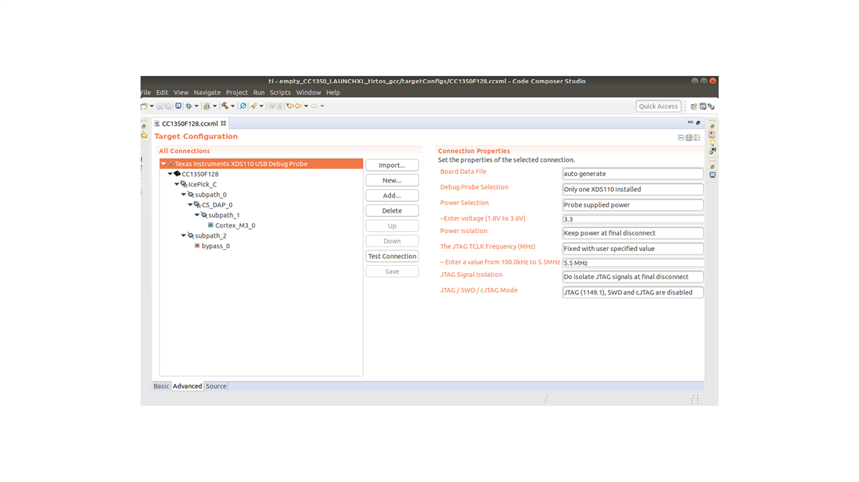

  • You may find my connection property settings below
    An explanation about error can be found in the Debugging JTAG page (search for the error number), avaiable in the online help of CCS (menu Help --> Contents) or at the page below.
    https://software-dl.ti.com/ccs/esd/documents/ccs_debugging_jtag_connectivity_issues.html
    That said, yoru screenshots may indicate an issue with th lease change the options on the target configuration file:
    - JTAG / SWD/ cJTAG Mode to either cJTAG (1149.7) 2-pn advanced modes or JTAG (1149.1), SWD and cJTAG are disabled.
    - The JTAG TCLK Frequency (MHz) to Fixed with user selected faster value and in the option that opens down to Fixed 5.5MHz frequency.
    These options should increase the ability to connect to the device.

  • It still looks like it is using an xds100.  I suspect that a different ccxml file is getting used.
    Can you go to the view menu.  Select Target Configurations.  Browse to your cc1350f128.ccxml file.  Double click on it to open it, make sure it looks like your screen capture.  Go back to the target configurations view and right click on the file and select Launch Configuration.
  • Tried this as well. No luck. It is the same config file that I am using.

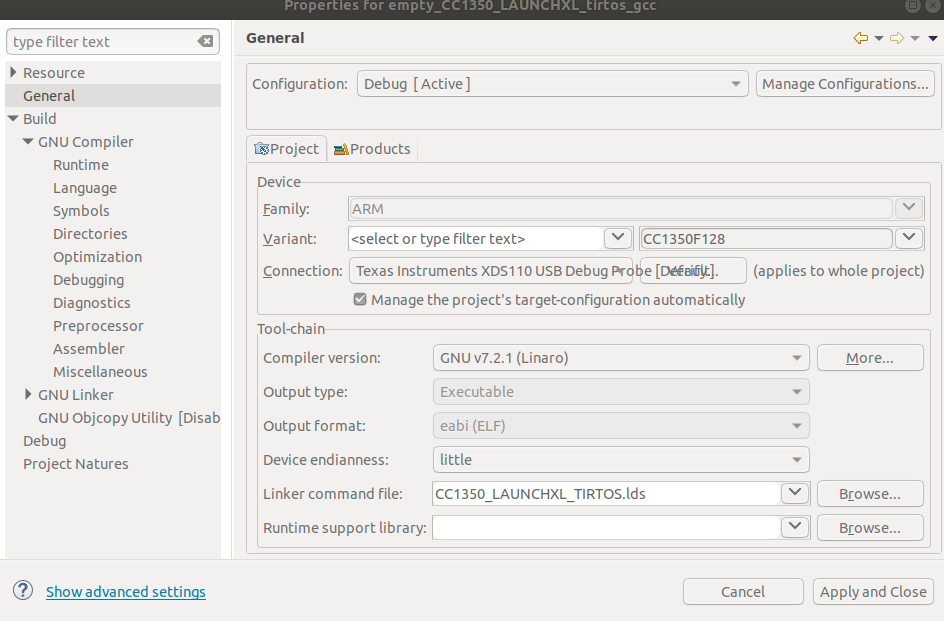

    If you go to the properties of the project what does it show here:
    John
  • Hi John,
    Please see the pic. below:
  • That looks good.
    When looking at the targetConfigs folder in the project it should show the .ccxml file with [Active] beside it like this:
    When I go to the bug button, click the down arrow and select Debug Configurations.  I can then select my project on the left.  It will show me the target configuration file that will be used on the right.  That should have something like ${target_config_active_default: project name} where project name is the name of your project.
    I think that either something different is specified in the Debug Configuration dialog or that another .ccxml file is specified as "Default" and is overriding what is set by your project.
    It is possible to set a ccxml as default by right clicking on it and selecting "Set as Default Target Configuration".  It would then look like this:
