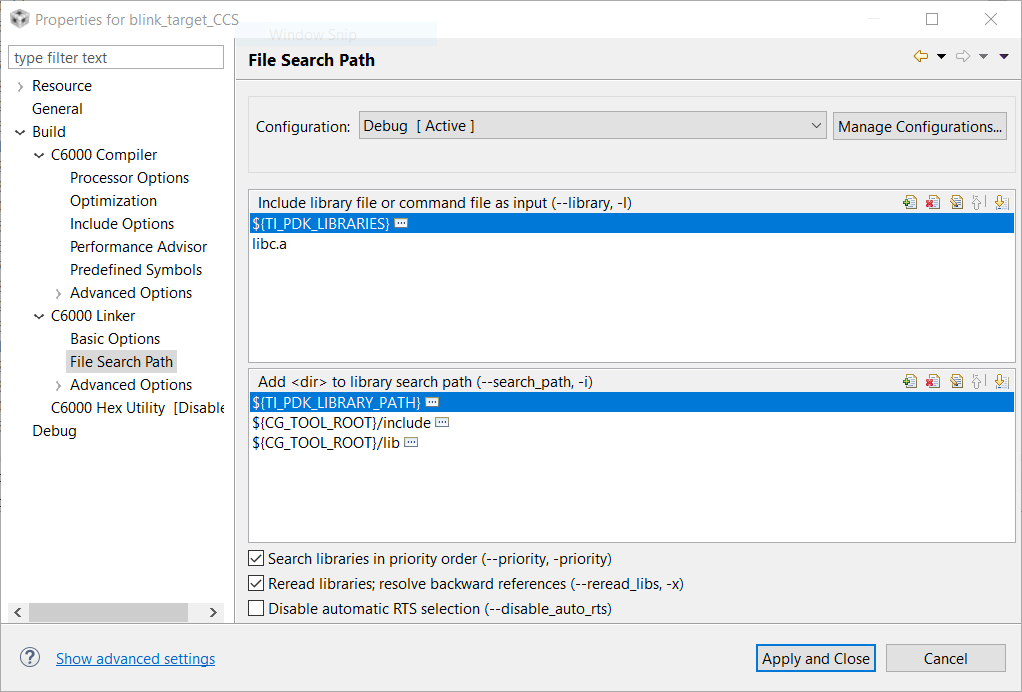

After tweaking with include/build paths and predefined  symbols settings for the compiler, I have managed to compile the code successfully. But in the linking phase I am getting errors for the unresolved objects which are actually the functions accessing GPIO hardware on my board. Following is the details of this error:

I am not sure about what I have to add in the linker file search path to remove above errors. I would be very grateful if anybody could help me fix this problem.

  • Thanks for your replay. Here is the screen clipping of linker include/search path settings: The TI_PDK_LIBRARIES variable is not pointing to any library file.
  • The path "C:\ti\pdk_omapl137_1_0_9\packages\ti\binary\ti\drv\gpio\gpio_profile\obj\Omapl137\C674\release" or similar contains object files like GPIO_drv.oe674 etc. but I have no idea which library file and search path I have to include to fix the problem.

  • Hi Abid,
    In CCS, right click on your project, select properties, extend the C6000 Compiler and select Include Options. Make sure you have the path to ti/drv/gpio, in the RTOS project this is ${PDK_INSTALL_PATH}/ti/drv/gpio.
    And for the initial creation of a bare metal application, you should refer to the following resource:
