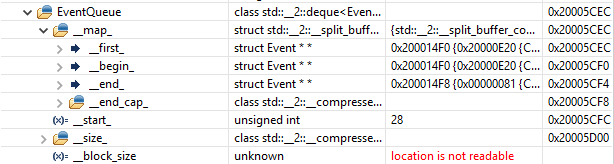

I complained that STL containers is not displaed human readable in CCS debugger. It was said, there is a CODEGEN-6031 bug, which has target releases ARM_19.6.0.STS, ARM_18.1.6.LTS, ARM_18.12.3.LTS.
I installed CCS 9.2 and codegen tools 19.6.0, but during debug STL containers are not human readable yes:
  • Hello Oleg,
    There were two fixes required to resolve the issue. One on the compiler side (CODEGEN-6031) and one on the debugger side (CCBT-2384).
    CODEGEN-6031 has been fixed in the releases you mentioned.
    CCBT-2384 is still not fixed. It is in the queue to be fixed but there is still no exact timetable on when it would be fixed.
