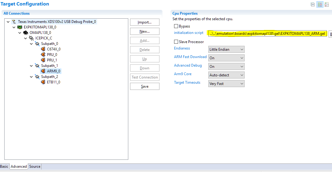

  • I tried lots of things to find clues. Here are some clues, that I hope can lead to a solution, (unable to load/debug programs on the OMAP-L138 ARM).
    1) The XDS100v2 probe <with updated firmware> works fine, and allows reading & writing the registers of the DSP and ARM. So, the probe does not seem to be the problem.
    2) The problem occurs when the ARM.gel runs, but not when the DSP.gel runs. The error is:
    ARM9_0: GEL: Error while executing OnTargetConnect(): Page fault occurred reading 0x01C10800
    at (*((unsigned int *) ((0x01C10000+0x800)+(4*LPSC_num)))&0x1F) [EXPKITOMAPL138_ARM.gel:939]
    at PSC0_LPSC_enable(0, 0) [EXPKITOMAPL138_ARM.gel:492]
    at PSC_All_On_Experimenter() [EXPKITOMAPL138_ARM.gel:251]
    at OnTargetConnect()
    3) That error occurs when menu Scripts -> PSC_All_On_Experimenter is run on the ARM, but not when that script is run on the DSP. (This routine occurs within both the ARM.gel, and within the DSP.gel.) So the problem seems to occur within the ARM.gel file, apparently within the PSC_All_On_Experimenter routine. The error occurs in a subroutine "PSC0_LPSC_enable()", which initializes the Power and Sleep Controller, the clocks, and phase-locked loops.
    4) The presence (or not) of the DSP.gel within the target configuration (.ccxml), has no effect on the above problem, either way.
    5) If the ARM.gel is removed from the target configuration (.ccxml), then the error doesn't occur when launching the .ccxml. But then is the ARM properly initialized, if it doesn't have a .gel?
    6) When the ARM.gel is either present or absent from the .ccxml, (and the DSP.gel is present), then the following error occurs when a program is loaded onto the ARM.

  • By much trial-and-error, I found a way to bring up both OMAP-L138 cores (DSP & ARM), without CCSv9 generating any error messages. At that point, both cores are connected, and have their memory maps loaded, and all the registers (from both cores) can be read and written. The DSP is fully usable and debuggable. So far, so good. But CCS generates error messages when loading a program to the ARM, so ARM programs cannot yet be run or debugged.
    Perhaps that is a step forward? <perhaps...>
    Here is how that is accomplished.
    I created a new version of the ARM .gel file. (I call it ARM.gel) In this version, go to the routine OnTargetConnect() and within it, comment out three subroutine calls, like this:
    OnTargetConnect( )
    Clear_Memory_Map();
    Setup_Memory_Map();
    // PSC_All_On_Experimenter();
    // Core_300MHz_mDDR_150MHz();
    // Wake_DSP();
    Those three subroutines cause CCSv9 to complain when trying to connect to the ARM, (so that is why we comment them out.) The purpose of those three subroutines will be accomplished instead by the DSP .gel. (The DSP .gel runs PSC_All_On_Experimenter() and then Core_300MHz_mDDR_150MHz().
    Edit the target configuration (.ccxml) to use the new ARM.gel, and make ARM the "slave" to the DSP.) And Save the .ccxml
    Then connect to the board, like this:
    View -> Target Configurations,
    select the target configuration (.ccxml),
    <right-click> Launch Selected Configuration
    Switch to the Debug window.
    Select the .ccxml
    <right-click> Show all cores
    Expand the list of cores under the .ccxml
    Select the DSP core (C674X_0)
    <right-click> Connect Target
    (Note: This will run the DSP .gel, and connect to the DSP)
    Menu Scripts -> Wake Core -> Wake_ARM
    Select the ARM core
    (Note: This will run the ARM.gel), and connect to the ARM)
    At this point, you can read/write all registers on both cores, and view their entire memory map.
    But unfortunately, loading a program to the ARM still causes an error, so it cannot be run or debugged.
    That seems to be a step forward. Any clues on what to try next?

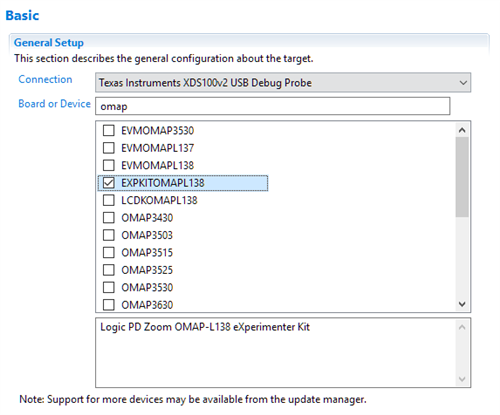

  • Hi Walter,
    Could you please try creating a new target configuration and selecting "EXPKITOMAPL138" as the Board or Device, as shown below?
    This will auto-populate the target configuration with the necessary GEL files bundled with CCS for both the ARM and DSP core:
    After saving, open the target configurations window and right-click on this target configuration and select "Launch Selected Configuration." You should then be able to connect to the ARM (need to always connect to the ARM first) and then DSP.
    This should work as-is, you shouldn't need to make any modifications to the GEL files. If this doesn't work, it most likely indicates a hardware issue.
    Hope this helps. Please let us know how it goes.
    Sahin
  • Sahin,
    Thank you for your help, and your careful instructions. I did exactly as you described, (which is also what I had tried previously). CCSv9 generated the same "OnTargetConnect()" error as before. (See above.)
    However, I noticed something I hadn't noticed before, (though it was probably there before). That is, despite the so-called "OnTargetConnect()" error, I was still able to "connect" to the ARM & DSP. I can read/write the registers, and the memory maps, and I can read/write various memory locations on both processors. In other words, it looks like it's connected and I have a operational system. (All I have to do is simply ignore the error message! Yes!)
    However, when I then try to load the program, I get the same "load failed" error report as before, (see previous posts). This error is more significant (and cannot be ignored), since I cannot proceed to debug the program.

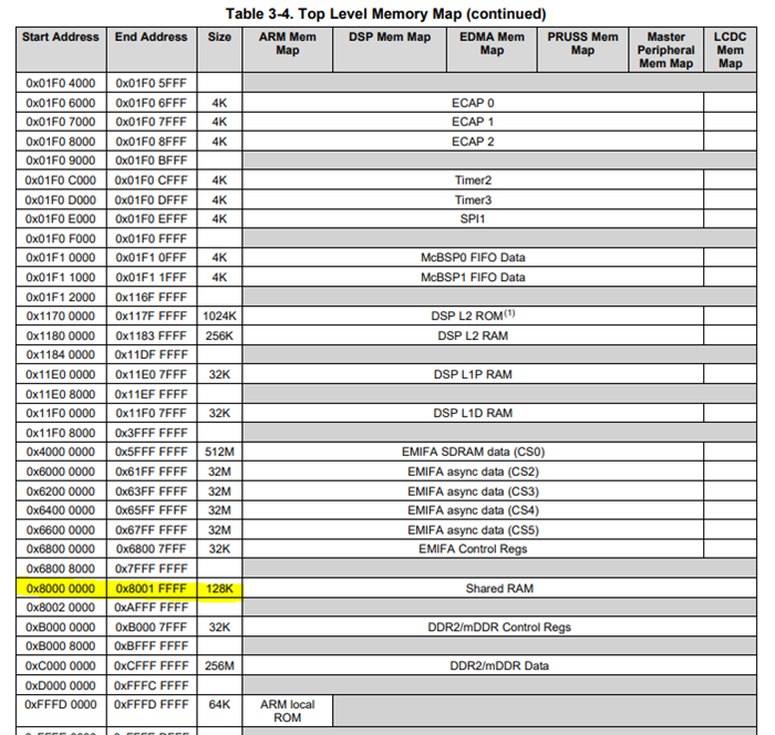

    At this point I believe my XDS100v2 probe works, and my Experimenter OMAP-L138 board works, (the board is new, unused, out of the box, and I get the same error on both the old board and the new board -- so I think the board is not the problem.
    I am starting to think the problem might be in the linker command file? Maybe the program is getting loaded to an invalid memory address??? My linker command file is the one CCSv9 automatically suggests for the OMAP-L138, (called OMAP-L138.cmd)
    After much experimenting, I think I've found the problem. That linker command file (OMAP-L138.cmd, the one that CCSv9 automatically populates into the project properties), it loads the program into a memory area called "SHRAM" (for "shared RAM"). It defines that area as having an origin=0x80000000 and a length=0x00020000.
    I checked on my system, and the DSP can read/write those addresses, but the ARM cannot. This is why my ARM program fails to load into memory -- the ARM cannot read/write those addresses of RAM. The problem is within this default linker command file for the OMAP-L138. (If I am right, it can load DSP programs to SHRAM, but not ARM programs.) Can you confirm this on your system?
  • Hi Walter,
    That is strange...
    The ARM has access to the SHRAM region and should be able to read/write to those addresses. This is shown in the memory map summary in the OMAP-L138 datasheet:
    Could you please confirm/try some things - I would like to make sure we are covering all bases:
    • Please confirm you are connecting to the ARM core first so that it wakes up the DSP.
    • Please ensure you are power cycling the EVM between connects/code loads - if not, and code is already running on the ARM, the MMU may have already been enabled and is protecting certain regions from being accessed.
    • Please ensure the Linux SD card is not inserted and Linux is not already running on the ARM - this would cause the MMU to be enabled and protect certain regions from being accessed as well (you indicated the DIP switches are set to emu debug so we should be okay here).
    • Is the example application you are trying to load a TI-RTOS based project or bare-metal?

    We found a bug in the MMU setup of the EXPKITOMAPL138_ARM.gel file, line 287:
    GEL_MapAddStr( 0xFFFE0000, 0, 0x00002000, "R|W|AS4", 0 );   // ARM INTC
    This line is attempting to write to a reserved section of memory (0xFFFE0000) as you can see from this snippet of the memory map:
    This line needs to be updated to write to 0xFFFEE000 instead. Could you please make this fix and try again?
    Sahin
  • Walter,
    Can you try to configure your board with the EVMOMAPL138 instead of the EXPKITOMAPL138? The routines that initialize the hardware have slight differences that may be the root cause of this issue.
    I personally don't recall what are the exact differences between the two kits, but the GEL files are quite close but with different peripherals initialized.
    Sahin,
    Well spotted. This will be fixed in a future release of the device support package for both the OMAPL138 and the AM1808 (which also has this bug).
    However, the Gel_MapAddStr() function only configures the debugger to show or hide the various memory segments of the board/device and do not perform read/write operations. In this case, I suspect the problem is somewhere else.
    Rafael
    I tried that already. (Actually, my previous board was the EVM, and had the same problem, so I switched to the Experimenter board (with a different SOM module), and still have the same problem.)

  • Walter,
    Indeed the ARM core seems to be working fine and the issue is with the interactions between the CCS/Debug Probe/Device.
    Walter Snafu said:
    Is it possible the Gel MapAddStr() function is misconfigured on the shared memory?
    This is correctly configured in both experimenter and EVM GEL files for the ARM core as Read/Write and 32-bit width.
    GEL said:
    /* Shared RAM */
    GEL_MapAddStr( 0x80000000, 0, 0x00020000, "R|W|AS4", 0 ); // Shared RAM
    When you open the Debug session (without code loaded), what do you see in its memory map? (menu Tools --> Memory Map)
    If you see something different than what is shown below at the offending address, try the GEL files I attached here.
    Rafael

  • Rafael,
    My ARM Memory Map shows the same thing that you see. It's Memory Map looks correct. So the GEL file is correct on this point.
    Perhaps a new clue: When connected to the ARM (with focus on the ARM), the Memory Browser shows "????????" for the shared memory (address 0x80000000 and following addresses). But for the immediately preceding addresses (0x7FFFFFFE8, and preceding), it shows "--------". So CCS recognizes some kind of difference between the two memory ranges. In particular, something is causing CCS to display "????????", instead of either the correct data, or "--------". The CCS software is recognizing some difference between the two memory ranges. Is that a clue?  What would cause CCS to display "????????"?
    Thanks always for your help.
