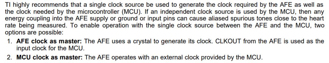

 We are working on a project and we want to use the AFE4403 device. We have noticed in the datasheet that TI recommands to one crystal oscillator if we interface the device with an external mcu (picture below).
If we are using the second solution (MCU clock as master), then we should connect the clock output of the mcu to the XIN pin of AFE4403 and leave XOUT pin of AFE4403 NC, right ? Or XOUT pin should also be connected ?

  • Hi Mike,
    In external clock mode with an external clock fed in through the XIN pin, XOUT can be left floating.
    The clock signal level can be the same as the receiver supply voltage.
