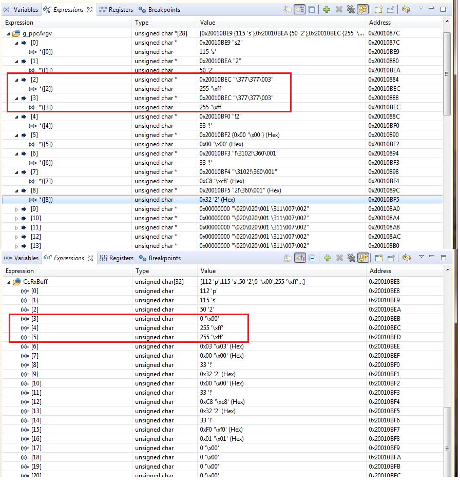

    If you mean libc.a it is in the project include path and build paths tab, this is non-OS code. CCS debug of the array cell shows 0x0 on left side but has many other /xxx/ bytes shown, not sure where they came from other than memory address space during initialization.  Yet (static int)  is not being set to 0x0 when an array pointer. We must explicitly set static (int) to 0x0 or the passed contents from Cchar[i] are not started anywhere above cell 0x0 inside limited BUFFER space. Edit: rtsv7M4_T_le_v4SPD16_eabi.lib
    Recently discovered Cchar[i] in the (for) loop i=0 with #defined BUFFER cell pointer via (i) is not being reset 0x0 upon return to the (for) loop i=0. So the array cell contents of BUFFER are Not being incremented from  0x0 upon next call into function. So BUFFER is considered truncated in strings being passed to reads of BUFFER in other functions. IE: the passing data to another function via header (* dbyte) into BUFFER is not keeping contiguous with Cchar[I] cell loading, the cell pointer is not starting from 0x0 as it should each time for loop is initialized.
  • I modified the code above post to produce the results shown in both captures of Cchar[I] and CcRxBuff[BUFFER].
    Other times the pointer may start from 0x0 in both the argument buffer in the called function from the passed char* from CcRxBuff[] . Yet when pointer into BUFFER is tested inside the function posted the printed CcRxBuff[] results are not re-started from I=0x0. However the results are often truncated after byte 16 of the UART FIFO being B2B read from UARTDR in read sensitive register C+ POP.

    Correct the startup.ccs code does not seem to clear out all the array cells on far right only as 0x0. Yet startup.ccs .bss clear seems to leave odd data, debug shows "!\3102!\360\001" have no idea what all those bytes came from. Do suspect corruption of BUFFER  passed data into called function header (*buffer) is not what was or should have been received into global BUFFER.
    First few bytes are correct in argument array copied from global BUFFER, the other bytes are unknown data without the trailing '!' 0x21. Notice the inline printing of RX data is correct but not when BUFFER is replayed after bulk copy of contents via char* header passing. The top code if(i>32) loads buffer contents to caller shown below.
    Passing of BUFFER contents to called function does not and should not write into array cells of the caller as seems occurs during passing of char *.
    iPStatus = CmdLineProcess(CcRxBuff);
  • Found the cause of array corruption.
    Second code example attempting to read contents of BUFFER via command s2 was writing into the array cells rather than pointing to them via = n. Warning "char" can  not be assigned to entity of type "char *" in 1st example. Yet the other code parts to convert hexadecimal to integers require "char" type, not "char *".
    Attempting to merge two individual RX array hex bytes and into integer string proves difficult. So much easier via machine language than C++. And atoi was subtracting 0x30, '0' from the hex strings, no warning with 1st C+ syntax below but not other clib.a calls for hex string conversions to integers. So I have added HexToChar() conversion is not compatible with array char type pointer value being the physical cell number.
