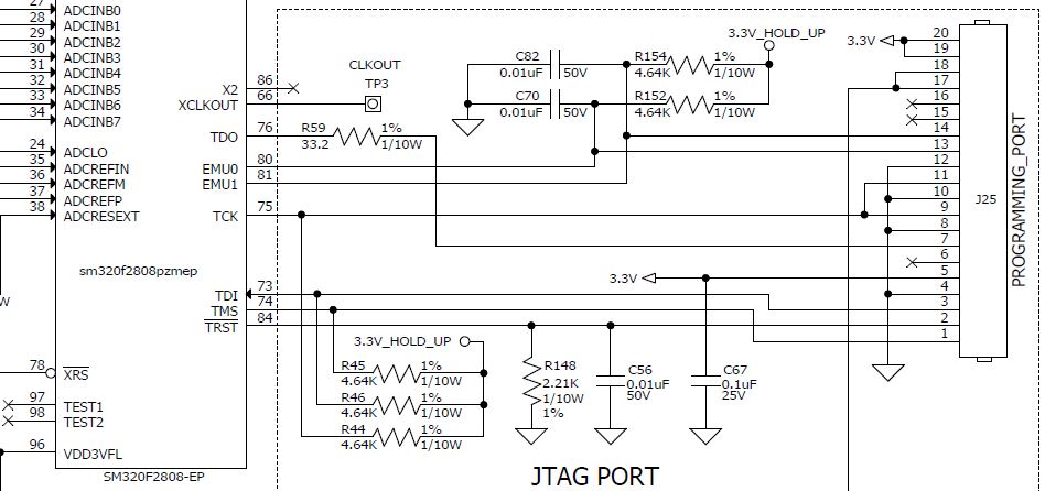

I have the micro pins TRST connected to the RESET line
TDO - TDO
TDI - TDI
TMS - TMS
TCK - TCK
GND - GND
Are there additional lines I need to be connecting to the micro?  Why would I be getting this error?  I'm stuck at this point and not sure how to move forward.

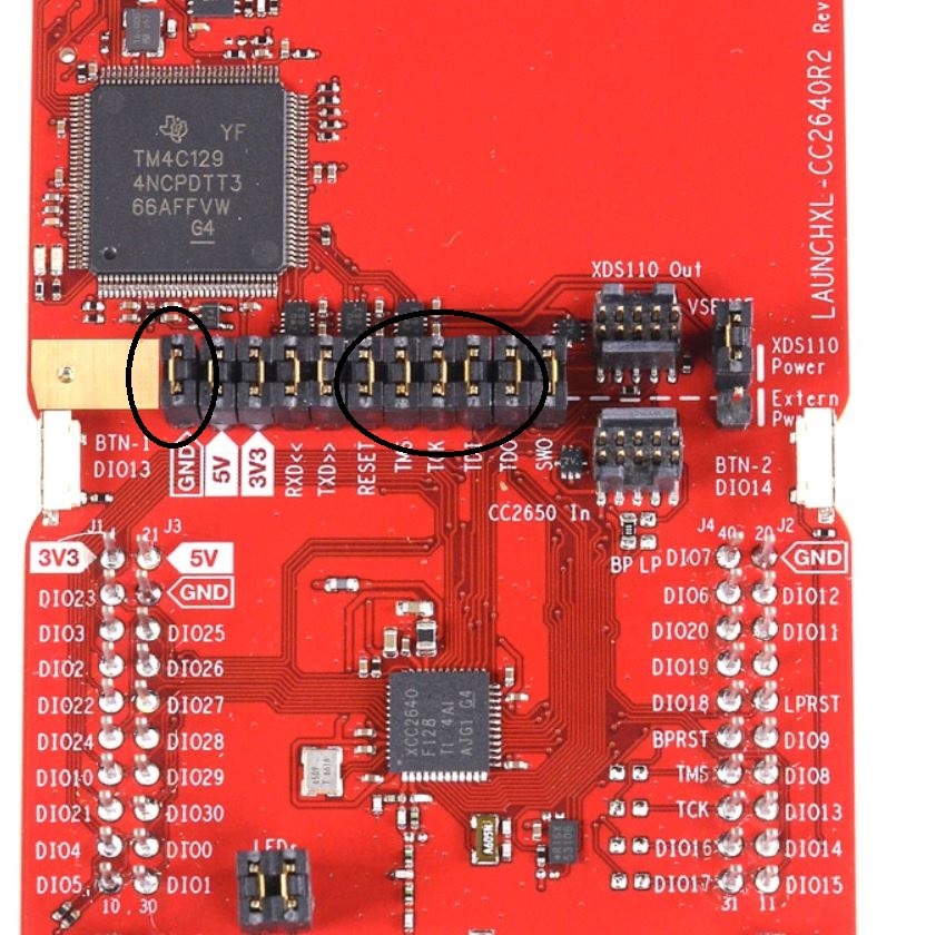

  • The jumpers circled in black were removed, and I connected my jumper wires from the top side to my board under test.
    Thanks for sending the photos. Two considerations:
    - The C2000 designs usually have a strong pull down on the nTRST signal - the 2.21kΩ resistor. I would increase that to at least 4.7kΩ
    Reference: section Invalid data read back of the Debugging JTAG page at:
    https://software-dl.ti.com/ccs/esd/documents/ccs_debugging_jtag_connectivity_issues.html
    - The pull ups on TDI, TMS and TCK should not be needed.
    Reference: section Target Connection Design of the XDS Target Connection Guide page at:
    https://software-dl.ti.com/ccs/esd/documents/xdsdebugprobes/emu_xds_target_connection_guide.html
    - TDI and TDO should be connected to the pins of the same name on the target device.
    Reference: same as above.
    I will think of additional details and report back in case I can think of any relevant tips.
    Rafael

    Sorry about the delay; I got access to my boards and was able to test the XDS110 Debug Probe in both the LAUNCHXL-CC2640R2 and the standalone TMDSEMU110-U. What I found was that the standalone properly asserts the nTRST pin before trying to connect, which is a requirement of the F28x family of devices. The RESET signal on the launchpad did not perform this, thus causing the JTAG state machine to be in an unknown state.
    LAUNCHXL-CC2640R2 (never triggers)
    TMDSEMU110-U (triggers at the initial nTRST assert)
    From that standpoint and the fact the nTRST signal is not routed out of the launchpad's built in XDS110, I have to assume the launchpad is not compatible with 5 wire JTAG used by the F28x family of devices. I also could not find a way to manually assert this signal, not from CCS nor using the xds110reset utility.
    I will check additional details and report back to this thread if I find anything relevant.
    Rafael
