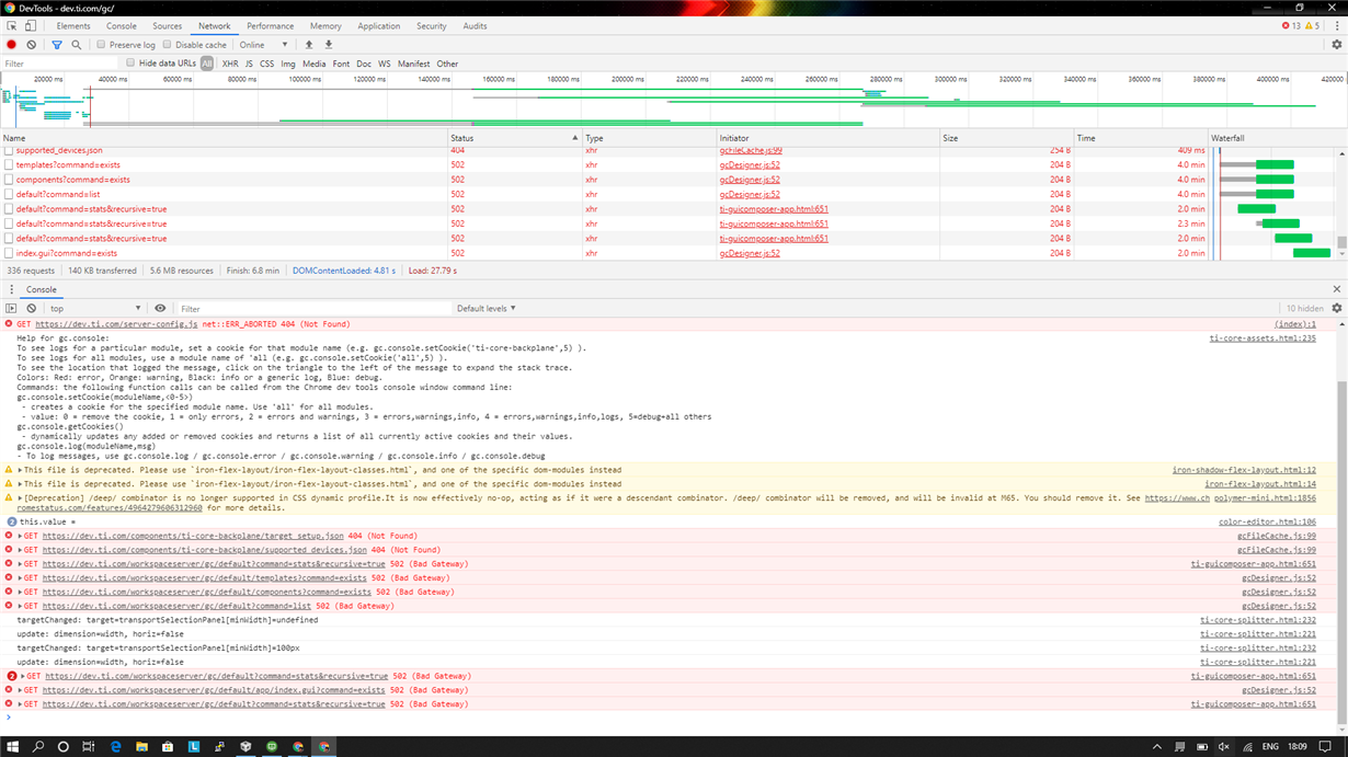

I am unable to see my projects in GUI Composer 2 (dev.ti.com/gc). I had 4 projects in GC which are no more visible. My workspace is empty and I am unable to create new projects or import existing projects. I tried importing project from Gallery as well, but even then it is not working. Below is the screenshot of Chrome DevTools, when I try to open GUI Composer Link. Anxiously waiting for support.
If I click on 'Create New Project' nothing happens.
If I click on 'Import Existing Project', after uploading zip file, it endlessly displays 'Processing' pop-up.
Thanks and regards,
Abhay Lolekar

Hello Abhay,
Can you try starting GUI Composer now?
Let me know if you still have any problems?
Dobrin

Hi
I am really hoping for help here. I am experiencing the same.
Monday when I logged into my cloud space, all my projects were gone. I just see an emply workspace and nothing else.
I tried again today and still the same.
It seems I can create new projects - at least the button reacts. But I dare not click too much around.
Some history, I was coding there maybe 2 months ago. Meanwhile my colleague from China logged into to my account and changed the address (and apparently the language). He did this because he wanted to buy some CC-debuggers for another project. So he did not enter the dev.ti.com area, just my profile.
I dont know if this is related, but this is the only explanation I can see.
Please help! I dont have any back up of the most recent project I worked on, so I am kind of lost here.
The workspace is identified by the customer's e-mail. Since the customer had switched his e-mails in his profiled his workspace was empty.
The problems was resolved by asking the customer to switch back to his old e-mail. There is a feature request that will address this use case.
