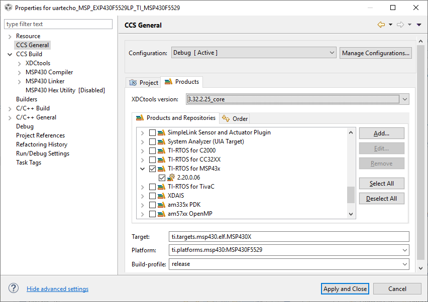

  • Hi Aarthi,
    We have verified the XDCTools version and made sure that the TI-RTOS for MSP43x is checked. I have attached the image for your reference.
    The build still fails and the errors still persist. I have attached the build log. Please have a look and let us know what could be the issue.

  • I see that you are building with compiler version 18.1.7.LTS. The reason I did not see the same error is that I was compiling with version 18.1.4.LTS. Although 18.1.4 builds without errors and 18.1.7 generates linker error, both versions will not actually run properly on the target. This is a known issue with using TI-RTOS for MSP430 with newer versions of CCS/compiler tools. The issue is captured in the Known Issues page which is linked to from the TI-RTOS download page. And also mentioned in this forum post: https://e2e.ti.com/support/microcontrollers/msp430/f/166/t/822945
    Due to this issue and the fact that there is no continuing support for TI-RTOS for MSP430, we recommend using older versions of CCS, compiler and XDCtools as documented in the TI-RTOS Release Notes.
