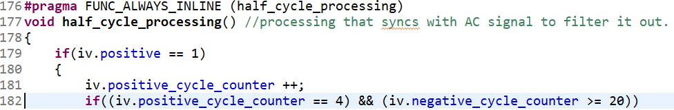

What are the source of 4 and 20 in the following codes?
Part Number: UCD3138PFCEVM-026
what do you mean "source"? please explain your question
What I mean, how to get 4 and 20 ?
The two values are constant ?
Do I explain it clearly?
Hope for your help,sincerely, thanks.
use 4 and 20 to make sure AC is really a positive cycle, not a spike, and it just changed from negative cycle to positive cycle
