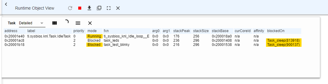

ROV seems to report wrong stack size for 2 of my tasks. I have only 3 task, 2 application task and 1 system default idle task.
It will report correct stack size if I set task stack size to 400, 512, and 1024. If I set the stack size less than 400, it seem to report wrong stack size.
For example, if I set both the stack size to 300, the ROV will report stack size are 296 bytes for both of my task, and their stack Peak are 272 and 216, both still under the 300 bytes limit. However, the tasks seem to run fine.
What have I done wrong??
Here is how I set up my tasks:
