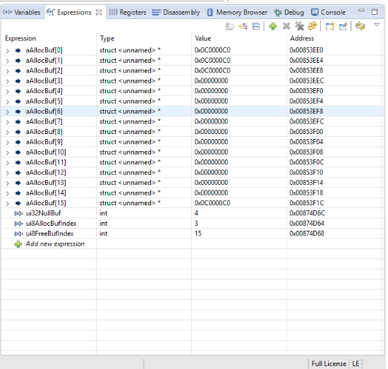

I am working on messageQ communication between ARM to DSP. I am creating two tasks in DSP, in first task MessageQ_get is placed in while loop. In second task I have MessageQ_free, messageQ_alloc and MessageQ_put. Dsp load i am building with the CCS v6.
ARM code has one thread, inside the thread i have messageQ_get and messageQ_put and ARM load is building in linux terminal.
I have declared messageQ variable as follow
#define MSGQ_ALLOC_SIZE   16
MessageQ_Msg aAllocBuf[MSGQ_ALLOC_SIZE];
NOTE: I have allocated a 512 bytes of heap for messages.

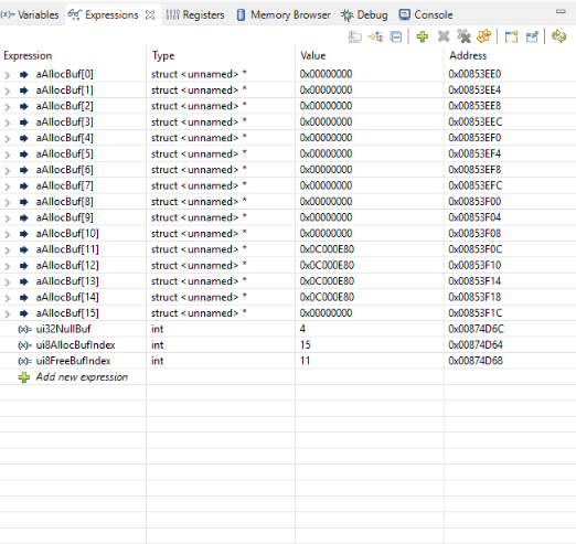

I have a buffer of 16 which is used to allocate, put and free the message. When I am trying to allocate for aAllocBuf [0] , aAllocBuf [1] and so till aAllocBuf [15] it is allocating with the same address  for all the indexes of a buffer. After four allocations, I am freeing the buffer and it is freeing the allocated memory for some random messages and DSP core0 is crashing by throwing an error as follow
[t=0x00000009:c397944e] ti.sysbios.heaps.HeapBuf: ERROR: line 297: assertion failure: Cannot call HeapBuf_free when no blocks have been allocated
ti.sysbios.heaps.HeapBuf: line 297: assertion failure: Cannot call HeapBuf_free when no blocks have been allocated
xdc.runtime.Error.raise: terminating execution
I am attaching .rar of my CCS project and ARM .c file.
Kindly refer my CCS project and ARM .c file for more understanding.
I AM ATTACHING THE SCREENSHOT OF MY TWO RUNS..
DSP project n ARM .c file.rar    This is my CCS project for DSP and also it contains the .c file of ARM.
ccsv6
bios_6_41_01_36
ipc_3_36_01_11
xdctools_3_31_00_24_core
 TCI6638K2K platform
windows10
Thanks n Regards
Mohan
  • Hello Mohan,
    Once messageQ_put is called, the caller loses ownership of the message and can no longer free or delete it. I suspect this is the reason for the error you are seeing. You can free the message after calling messageQ_get and receiving the message.
    Sahin
  • Hi Sahin,
    Thanks for your reply.
    Sahin
    Does this means which core (either DSP or ARM) has messageQ_get they only need to do messageQ_free ..?
    My test bench is like below:-
    Do you see any issue or any missing step in the above test bench..?
        We are assuming that ARM get and put the Msg back with the same address by way we wrote our program. But we are not sure, ARM is going to take the same address which is allocated by the DSP during the alloc or he has the different address..?
        As per your comment whoever puts the MSG will lost the control on that msg. During our Msg exchange example since we are using same address to put back from the ARM, weather DSP can gain back the control & can it free that allocated memory for MSG..?
    Mohan.
  • Hi Mohan,
    IPC follows a threading model where there is a single reader and multiple writers. The single reader thread calls MessageQ_create(), MessageQ_get(), MessageQ_free(), and MessageQ_delete(). Writer threads call MessageQ_open(), MessageQ_alloc(), MessageQ_put(), and MessageQ_close().
    The "caller" I mentioned in my previous post refers to a single thread, which could be a Task, Swi, or Hwi on different cores or on the same core.
    You will need to modify your system so that the thread calls messageQ_free after calling messageQ_get.
    Sahin
