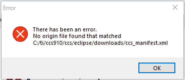

I had someone run into this error when attempting to run CCS after an update on CCS 9.1.
There has been an error. No origin file found that matched C:/ti/ccs910/eclipse/downloads/ccs_manifest.xml
What could this be attributed to? Failed extract of update files?
Is easiest fix just to reinstall CCS or will this possibly resolve by restarting the machine?

    That's part of the download of the update. Could you please zip up the ccs/install_logs folder and attach here? This will help us debug things.
    Also, can you list the files/folders in ccs/eclipse/downloads? I can take a look at the logs and let you know if the user needs to reinstall, i.e. if the update failed. Rebooting will not help in this case.

    It looks like it failed to update a component, and unfortunately, there’s no way to recover from that. I would recommend downloading and installing CCS 9.2.0 afresh.
    If you want to keep the install as is, you can remove the contents of the downloads folder, so it will stop trying to install the failed update and let you keep using CCS, but I’m not sure what other issues you’ll run into.

  • Hi Danish, I removed the files in the download directory and I was able to run CCS without issue. That is a great fix until I can upgrade. Thanks for your help.
    Cheers, Paul
