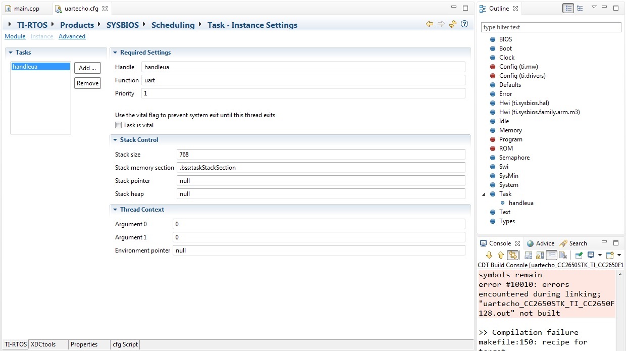

I create a task using the XGCONF GUI. The settings are shown in the screenshot below:

unresolved symbol uart, first referenced in C:\Users\rushestm\workspace_v8\uartecho_CC2650STK_TI_CC2650F128\Debug\configPkg\package\cfg\uartecho_pem3.oem3
If I create the task without gui, it's works properly.
What could be my mistake?
Thank you in advance
  • Hi Egor,
    Since the function is in a C++ file, it is getting name-mangled. Try adding an extern  "C' around the uart function.
    #ifdef __cplusplus
    extern "C"
    #endif
    //uart function goes here
    #ifdef __cplusplus
    } // extern "C"
    #endif
