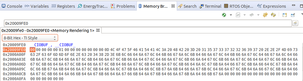

I read other threads in e2e to find a solution, but still the error continues. As I understand, during semi-hosting, the debugger places sw breakpoints where printf is used to print the buffer to console. Since we are using heavily printf function to get log messages from our application, sometimes the buffer overflows which results these errors. I realize that when the errors occur, the first couples of bytes in _CIOBUF_ are 0.

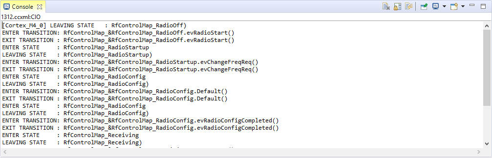

I see there are two executables - "GasSensor_v21.out" and "GasSensorTest.out". The first one does not run successfully. The second one does. I get CIO to the console for the second one:
Is "GasSensorTest.out" the one where you increased the heap size? DO you not get any such output?
