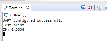

Trying to establish communication between ADC and  controller via SPI.
Data sheet of the ADC - https://www.analog.com/media/en/technical-documentation/data-sheets/AD7177-2.pdf
As per the data sheet, the command should be given to Communications register and its given that the best way to check if both the devices are communicating is by reading the ID Register ( Reference: Pg- 49,55)
According to that, I'm expecting to read 0x4FDX (Please correct me I'm wrong)
But I'm reading random values like : "128", "0", "255".
(Tried ways like using GPIO Interuppt, changing the filter configuration etc)
Struck here for over a week now. Not able to understand where I'm going wrong. Any help so as how I move forward is highly appreciated. Thanks!
Following is the source code:

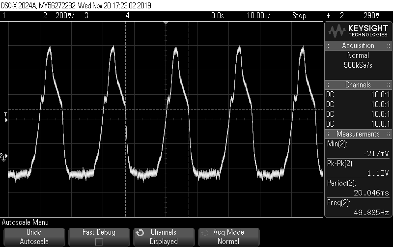

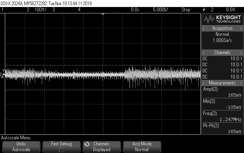

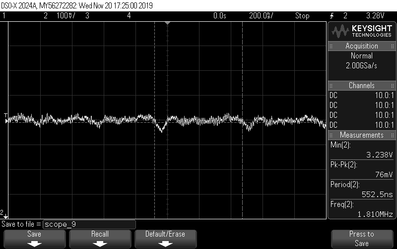

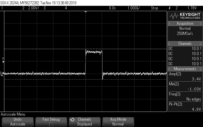

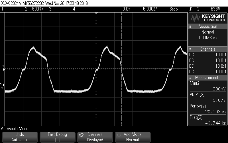

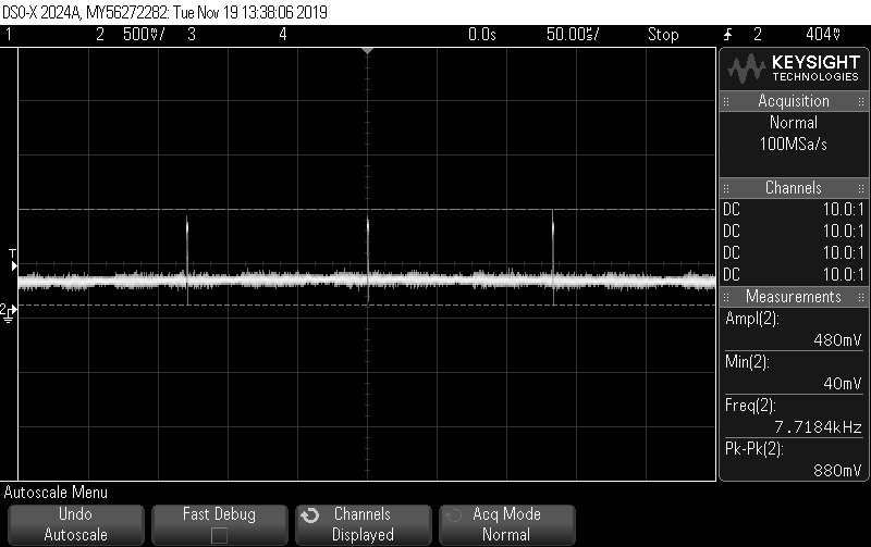

  • Without spending a lot of time learning my competitor's ADC and debugging your code, it looks to me like you should be using SSI_FRF_MOTO_MODE_3. I suggest that you use a logic analyzer or digital scope to capture the SSI waveform. From that picture we will be able to tell what is going on.
  • Dear Bob,
    Thanks for your response. As per your suggestion, I have configured it using SSI_FRF_MOTO_MODE_3. But there doesn't seem to be much of a difference in the waveform. I'm attaching the screenshot of DOUT from DSO.
     f DOUT
    Any leads would be helpful.
    Pranav
  • Unfortunately that does not help me much. I would like to see the waveforms of PA2, PA3, PA4 and PA5 all at the same time. (SSI0CLK, SSI0FSS, SSI0TX and SSI0RX). It is the relationship between these signals that tells me if the SSI is configured properly.
  • Dear Bob,
    Thanks for your prompt response. As per your advice, I'm attaching the screenshots of all 4 pins. What do u think is the issue?

    Here is what the SSI pins look like using a logic analyzer. Remember that I don't have an AD7177-2 chip attached so I get 0s where you should get 0x4FDx.
    Here is the output I received in Terminal:

  • Dear Bob,
    Thank you for spending your valuable time. I tried again with your code but didn't succeed. Circuit connected is as follows:
    PA2 - SCLK
    PA4 - DIN
    PA5 - DOUT (As per the configuration lines in code it should be connected to PA5) (Please correct me if I'm wrong)
    PA3 - CS
     I read 0xffff most of the times. Rarely I read 0x0000
    Scope shots of DIN, DOUT, SCLK and CS in the same order.
    What do you think is going wrong here?

  • Dear Bob,
    Firstly many thanks for your prompt responses. Your code does work. I've got the desired output. Thank you so much. I've been struggling with it for over 3 weeks now.
    2 key things to sum up the forum discussion:
    1) I was sending you the scope shots after all the configuration, transmission and receiving was done i.e., (when the code was running in while(1) ), so obviously the scope shots of your logic analyzer of mine didn't match mine. I put the config lines in a loop and tested. The SCLK, TX, CS were similar to your pictures. However RX was a little different(maybe because data was being transmitted from ADC)
    2) The command word to read ID register is 0x47. 0x07 is the command word to write to ID register. However ID register is a read only register and to read its value the command word is 0x47. (Reference - Data Sheet Pg: 49) [That was the only change I made to your code and I read 0x4DE
    Once again, thank you so much Bob.
