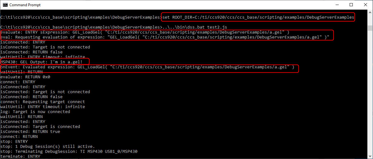

  • hmmm... i think it is issues with the paths. Try the following:
    make sure you use forward slashes for the path specified in your environment variable:
    set ROOT_DIR=C:/ti/ccs920/ccs/ccs_base/scripting/examples/DebugServerExamples
    then try:
    debugSession.expression.evaluate( 'GEL_LoadGel( "' + java.lang.System.getenv("ROOT_DIR") + '/a.gel" )' );
    This worked for me. Here is my verbose console output. the "I'm in a.gel" text is executed from a.gel.
    ki
  • That worked Ki, after we removed spaces in the directory name.
    Thanks much,
    Robert
