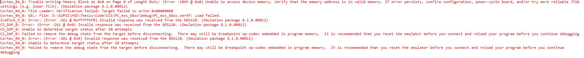

While trying to upload the firmware from CCS to the device in Debug Mode I got an error when loading the mss binary file.
I tried to uninstall the version of CSS I was using (9.0.0) and to install the 8.3 as suggested by  but It didn't solve the problem.
My device is ES1.0 version.
Do you have any suggestions on how to fix this?
Thank you very much in advance.

  • Hi Alessandro,
    Are you sure you have all of the correct drivers installed? Are you sure the device is in functional mode - check both the SOP pins and the switches on the front.
    Finally, can you use CCS to test the connection to the XDS110 on device - you can find this option by double-clicking on the target configuration. Please post the results of the test.
    Justin

    Dear Justin,
    Thank you for your reply. Actually I was using the device in flushing mode. In the official user guide of the people counting lab they don't say to set the device into functional after uploading the ccs_debug.bin firmware. Moreover, the DSS program was uploading without errors, therefore I didn't think that the problem could have been the device mode.
    By the way, I changed the device into functional mode and I was finally able to upload both programs successfully (DSS and MSS).
    Thank you very much for your support.
