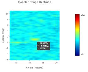

There is a version of the mmWave visualizer which saves data to a csv file. How can I save the range-Doppler map instead?

the mmwave SDK demo must first be configured to export the range doppler heatmap to the host.
See guiMonitor in
C:\ti\mmwave_sdk_03_03_00_03\docs\mmwave_sdk_user_guide.pdf
If the doppler heatmap is exported to the host. I think it will be saved to the csv file.
If it is not than you would have to reverse engineer the gui to add this feature
