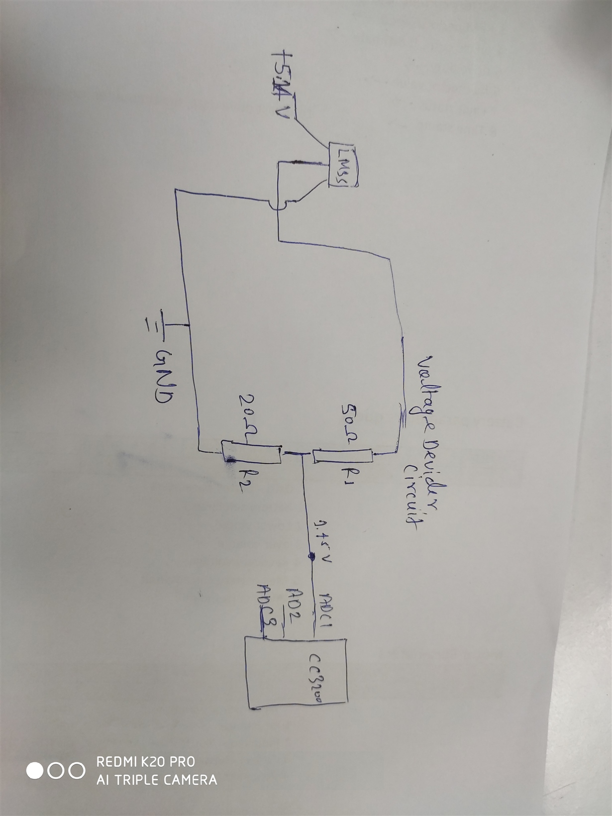

I have attached the LM35 DZ with cc3200 Launchpad as well as my custom board. I am giving the supply to sensor 5.14V. After that, I have the voltage divider circuit to reduce the voltage from 5v to 1.4v of sensor for ADC pin of cc3200 because cc3200 ADC pin voltage is 1.45. But, when the environmental temperature is varying, i can not any see any major changes in my sensor. Can I know why, what am I doing wrong?
I have taken the reference from ADC note and ADC demo also. But, i did not get any result. Please  check the code for this and please tell me the alternative steps to find out the solution.

  • Hi Black_Robot,
    Can you share a schematic of how you have the LM35 wired?
    How are you varying the environmental temperature? And what is the temperature reading at room temperature (25C)?
    Jalen
  • Dear Black Robot -
    did you use Pin Mux Tool already to set up the ADC? here is the example for you to use to make sure all hardware is correctly working
    Also, is there a reason you are using CC3200 vs CC3220 or CC3235 here? The LaunchPads and firmware for these devices are designed a bit better so you can use the ADC of the CC32xx a little easier.
    I am varying the temperature through Air Conditioners and taking the device with sensor outside of home or room.
    The temperature reading at 25 degree temperature is 18 and 19 degree. But, when the room temperature reduce, the temperature reading doesn't reduce or doesn't increase on increment of temperature.
    Please find the attachment of circuit.
    I am using only CC3200 Launchpad as well as my custom board. I am using only the ADC demo application to to get the voltage. I have just modified the code according to sensor as you can see the code in my above post.

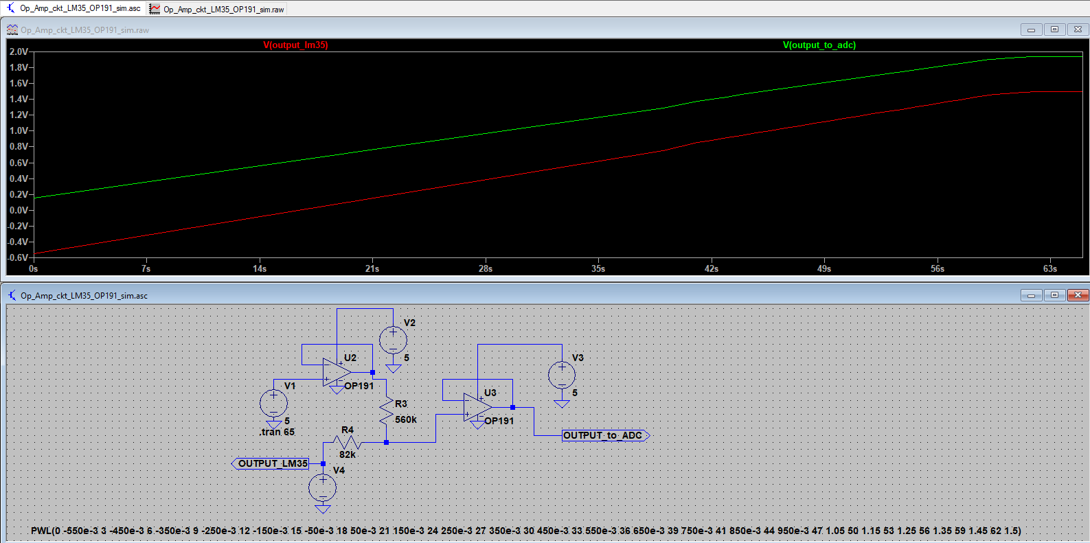

    The LM35 will output between -550mV (@-55C) and 1500mV (@150C), so the voltage divider you added is not helping you here. Would suggest wiring it like the datasheet shows with just a pulldown. You should be able to check this out with DVM before connecting to CC3200
    the other issue I foresee then you will have is that the CC3200 ADC does not measure below 0V. I think a circuit (may involve more than one op amp, etc.) will need to be designed to handle that for you. Let us know if you need help with that and we can try to assist.
  • Dear Black Robot-
    In anticipation of you asking for the op amp ckt - I spent some time simulating one for this use case. You may have to play around with the values for R3 and R4, but this is for sure in the ballpark of what is needed. hope this helps you out
