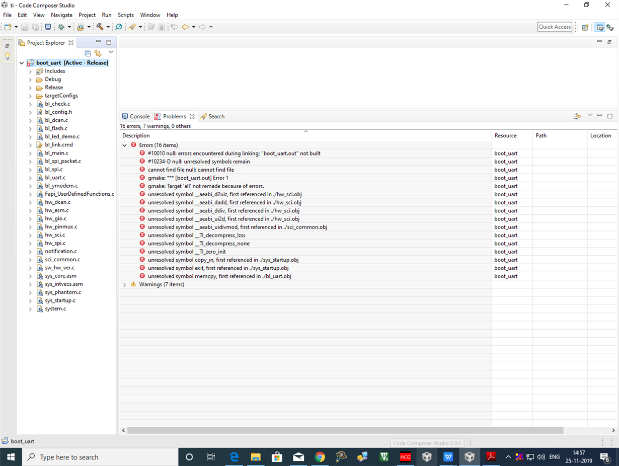

  • Hi Wang,
    I downloaded the code, and compiling the code in CCS v-8.0.
    Many errors are getting as shown below. So, please help me to solve this issue.
    Praveena M

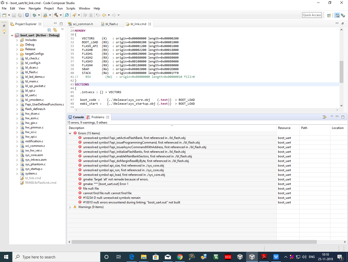

  • Part Number: RM48L952
    when we compiled we are getting the following errors.
    Please help us to solve this issue.
    Praveena M
    Please install F021 flash API and link the API library for your device:RM48:
  • Hi Wang,
    As, we followed your instruction. Still we are facing errors as shown below,
    Thanks and Regards,
    Praveena M
    When you installed the bootloader, the library should be installed. When CCS open the project, the lash lib should be loaded to CCS too. I will find the latest bootloader for you.

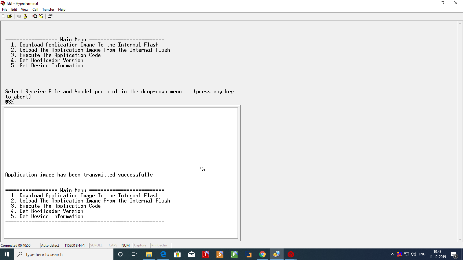

  • Hello Praveena,
    To download a binary file via HyperTerminal to the RM48x internal Flash, follow the procedure below:
    • Press “1” on the keyboard to choose the menu Download image to internal Flash.
      Then, in the Transfer menu, select Send file…
    • In the Filename field, type the name and the path of the binary file to be sent.
    • In the Protocol list, choose the Ymodem protocol
      Click the Send button.
    Following these steps, the bootloader loads the binary file into the RM48x internal Flash. The bootloader will display the file name, and file size in the Hyperterminal window.

  • Hello Wang,
    We generated .bin file.
    But, can you please tell the procedure how to download and upload the application code into board.
    As, we followed your steps, we got the following errors as shown below,
    Please, help us to solve this issue.
    Thanks and Regards
    Praveena M

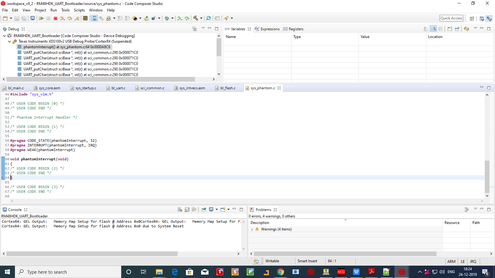

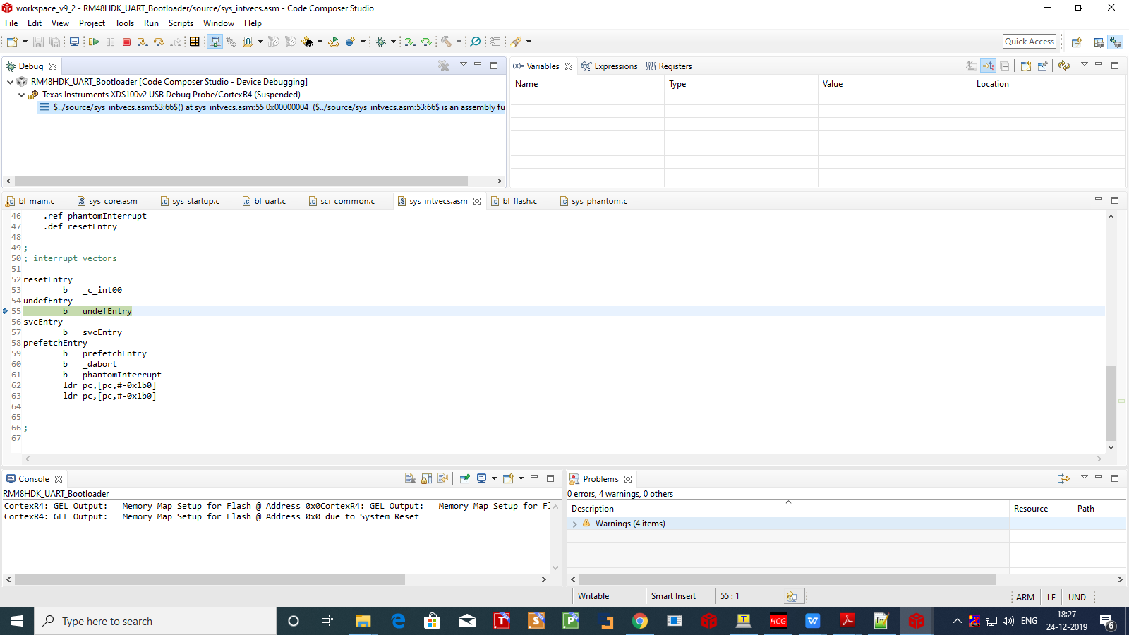

  • Hi Wang,
    The above one for if we Press "1".
    And if we Press "2" for upload. these are the issues.
    Please, help us.
    Thanks and Regards,
    Praveena M

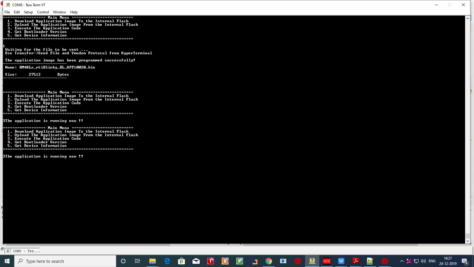

  • Hello
    I don't have experience of using dsgdfb terminal. Can you please try the ymodem in TeraTerm Terminal? I just tried, it works well.
  • Hi Wang,
    Earlier we were using Hyper-Terminal. Now, we tried in TeraTerm Terminal and tried to send your .bin file. The issues are shown below,
    Please, help us to solve.
    Thanks and Regards,
    Praveena M
  • Hello Praveena,
    Please copy those two files to your folder. _copyAPI2RAM_ in sys_core.asm and _copyAPI2RAM_() in sys_startup.c are overwritten after I updated the HALCOGen drivers. Sorry for that.

  • Hi Wang,
    Thank you for your reply.
    Here, we are not able to transfer the .bin file. It is showing as, "Failed to Receive the File". Please, support us to solve this issue.
    Thanks and Regards,
    Praveena M
  • There is no problem on my side.
    Ok, please add a breakpoint at:
      Size = Ymodem_Receive(UART, &tab_1024[0]);
    And run the code after you sending the file from the terminal.
  • Hi Wang,
    We are able to download the .bin file in debug mode. It is loading the .bin file, but if we reset the board.
    Then, it is showing the message as, "TI Safety MCU Application Team, qjwang@ti.com". And, it is not executing our application code.
    Thanks & Regards,
    Praveena M
    Please step through your code to check where the code is stuck in bootloader:
    fnRetValue = CheckForceUpdate();
    if ( !fnRetValue )
    #ifdef DEBUG_MSG
           UART_putString(UART, "\r Jump to application... ");

    The execution may be in your application, and abort (data or prefetch) may be happened after jumping to your application.
  • Hi Wang,
    As, we Downloaded the .bin file in debugging mode and when we press '3'-->Execute Application, it is showing as,
    When we Restart in debugging mode and Press '3'--> Execute the Application, it is showing as,
    When we load the code again and in debugging mode, if we press '3'-->Execute the Application, it is showing as,
    Please, help us to solve this issues.

  • Hi Wang,
    Once we load the boot loader code in debugging mode, blink LED application code is running. But, when we come out from the debugging mode and power-of and power-on, it is not blinking the LED and boot loader code menu also not displaying.
    So, we are still facing the problem. Kindly, help us to solve this issue.

    Are there any ESM errors? If the program is aborted, please check the abort status and the address which causes the abort (CP15 DFSR, and data fault address register, etc).

    Here, as you suggested for transferring a file we should keep breakpoint at this place "Size = Ymodem_Receive(UART, &tab_1024[0])" in debugging mode.
    We are able to transfer files with that method.
    But, we need to transfer the files without keeping break point in debugging mode. Please, help us to solve the issue.
    Thanks and Regards,
    Praveena M
  • Hello Praveena,
    Please use a bigger value for WAIT_TIMEOUT which is defined in bl_ymodem.h
    #if defined (TMS570LS04) || defined (RM42) //LS04 and RM42 runs 80MHz
    #define WAIT_TIMEOUT 0x240000 //Timeout=1.003 seconds
    #elif defined (RM57) || defined (TMS570LC43)
    #define WAIT_TIMEOUT 0xB60000 //Timeout=1.003 seconds
    #else
    #define WAIT_TIMEOUT 0x480000 //Timeout=1.003 seconds
    #endif

  • 1. Any interrupt is enabled in your bootloader? If yes, please disable them before jumping to application.
    2. Please make sure that the code has been jumped to application. What is value at 0x10000?
