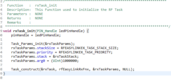

1.we were took 2 tasks in our program

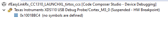

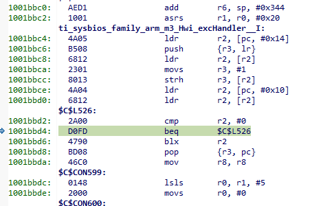

1.rxTask_init(ledPinHandle)- We receive data from our rf transmitter and sending to gsm module via uart.But 1st time data get properly to the gsm.but 2nd time program get stuck at some uart write api.we were also checked stack peak values which are within limits.
Please check our uart code below and please suggest us what we made wrong in our  code.
