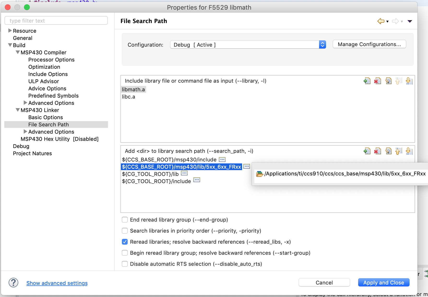

    I used the project wizard to create an example project for F5529.  It looks like libmath.a is included by default and the location for it is part of the search path.
    Here is what my build options look like.
    I have highlighted the path that matches where the library is.  In newer versions of CCS (I am not sure what version you are using) there is a little [...] that you can put your mouse over to see what a path that uses variables resolves to.  Basically libmath.a is locationed inside your ccs installation in /ccs_base/msp430/lib/5xx_6xx_FRxx folder.

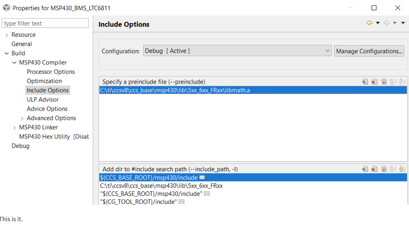

    also I add library search path. Then add "libmath.a" file into library files. then there were several errors as follow.

  • Thanks for the info regarding use of coff.  My answer is wrong.  A compiler expert will reply shortly.
    John

    >> Compilation failure
    SourceCode/UART/subdir_rules.mk:9: recipe for target 'SourceCode/UART/UART.obj' failed
    "C:/ti/ccsv8/ccs_base/msp430/lib/5xx_6xx_FRxx/libmath.a", line 1: error: expected a declaration
    From the errors it looks like libmath.a is trying to be compiled as a source file, rather than linked as a library.
    Can you show how the reference to libmath.a was added to the project?
    This is it.
    thank for your reply.
  • That's the wrong place to add a library to a project.  See the screen shot below for the correct place.
    Thanks and regards,
    -George
